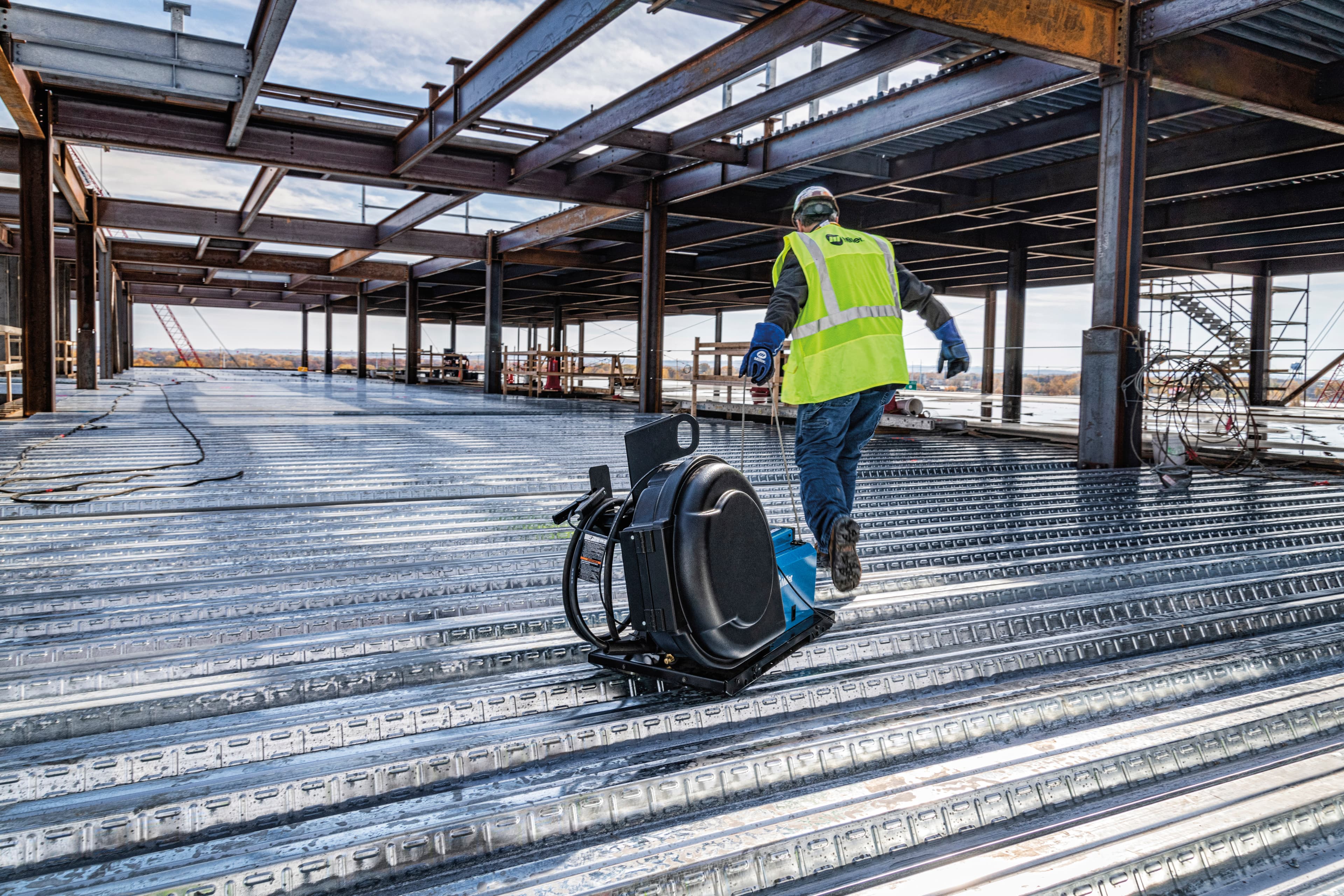

XMT 650 ArcReach Systems deliver integrated gouging at the wire feeder with a field-proven, constant current (CC) gouge process, so there’s no need for a separate power source for gouging. Although a CV process can provide satisfactory performance for gouging, most industries prefer the arc characteristics of a CC gouge process, which provides arc consistency and a deeper, cleaner trough.
Operators can remove more material per pass with an optimized gouge process without sacrificing control of the material being removed. In addition, the isolated gouging stud allows easy connection for gouging at the point of use, eliminating the need to disconnect the wire feeder and swap leads.
Welding systems used in structural steel fabrication need the power to run large-diameter welding wires and gouging electrodes for the thicker materials and complete joint penetration welds used in many applications. Using larger diameter wires helps operations minimize downtime and improve productivity thanks to the ability to put more filler metal in the joint on each pass and less frequent spool changeover.
XMT 650 ArcReach Systems provide 650 amps of power at 100% duty cycle to meet a wide range of job needs in your operation. The ArcReach 16 wire feeder is specifically designed for applications using 3/32-inch wire and 60-pound spools.
