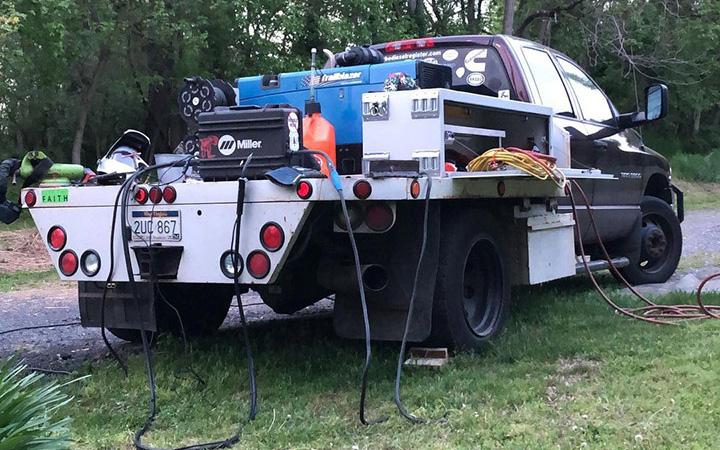

The big three: The must-haves on your truck are a welder, a generator and an air compressor.
These pieces of equipment help operators tackle welding and carbon-arc gouging — processes that many field fabricators use daily. A truck with a crane also comes in handy to move heavy equipment or pieces.

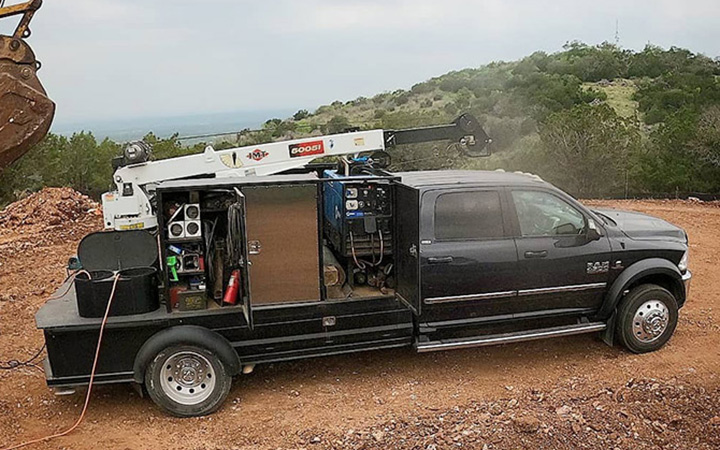

The truck:
Choosing a heavy-duty work truck versus a half-ton truck makes a big difference for equipment capacity. Plan ahead and choose a truck that provides the ability to grow as the business grows. You may need more space and weight capabilities to haul more tools and equipment later.

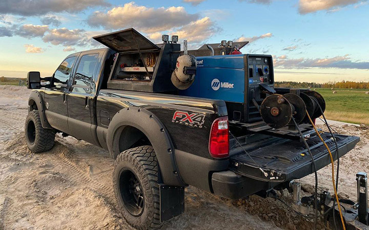

Spools and reels: These truck additions allow you to easily roll your welding leads in and out on the jobsite — a task you may do every day. They are especially handy when you need to quickly roll the leads in when bad weather hits.

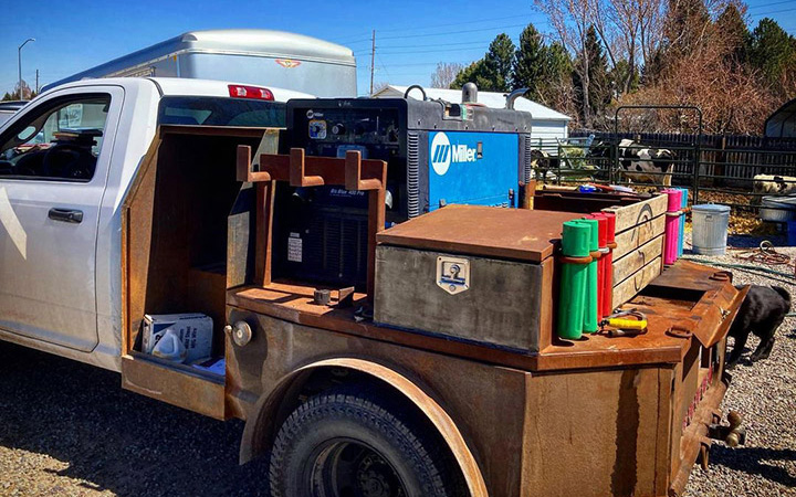

Filler metal storage: Proper storage for your filler metals keeps them from taking on moisture and being contaminated. Welding wire comes in 5-gallon buckets that can easily be sealed with lids, but you may want to invest in field containers to store stick and TIG rods.

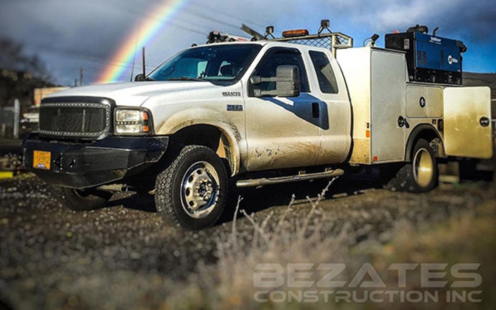

Wire feeders: These can be a great investment because of the efficiency that wire welding can deliver over stick welding. Wire welding can save hours or even days of time on big repair jobs compared to stick welding. If your machine is equipped with ArcReach® technology, using an ArcReach-enabled feeder provides parameter control at the weld joint for even more productivity.
