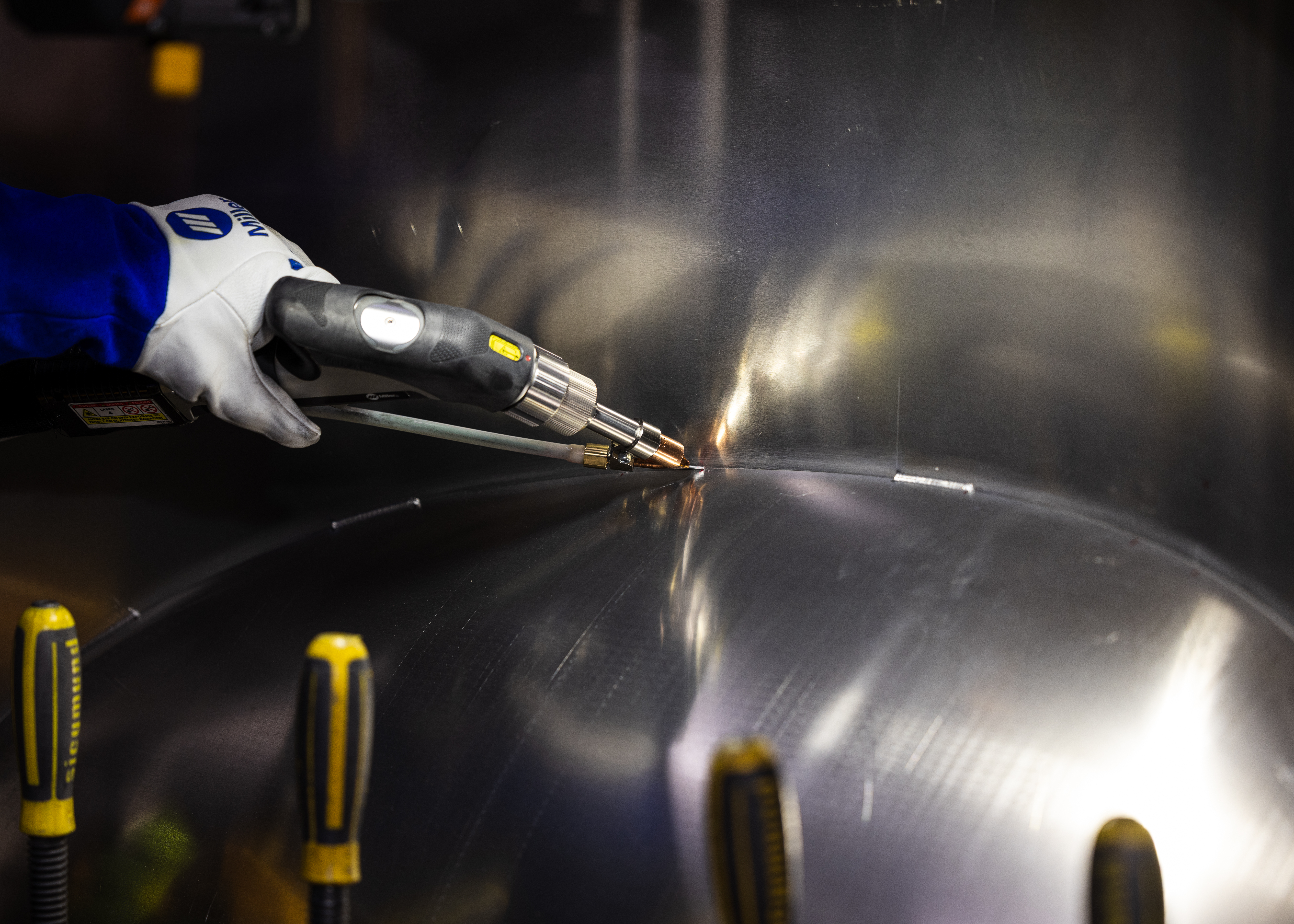

Why Aluminum Is Challenging for Laser Welding
Aluminum’s interaction with laser energy differs fundamentally from many other metals. In its solid state, it reflects a large portion of incoming energy, making it harder to initiate a weld. Once molten, however, absorption increases rapidly, allowing the process to stabilize.
Select modern handheld laser welders are designed around this transition. Rather than relying on operator intervention, these systems deliver controlled power density that consistently overcomes reflectivity, stabilizing the weld start and reducing variability from part to part.
How Modern Laser Welders Control Heat in Aluminum Applications
Beyond reflectivity, aluminum’s high thermal conductivity presents another hurdle. In conventional welding processes, heat can quickly move away from the weld zone, contributing to inconsistent penetration if energy input is not well controlled.
The high energy density of laser welding reduces this challenge compared to traditional processes, allowing heat to be delivered rapidly and precisely to the weld zone. Handheld laser systems intended for aluminum use engineered optics and focal strategies to concentrate energy where it is needed most, though weld integrity still depends on proper parameter selection, validation and ongoing process checks.

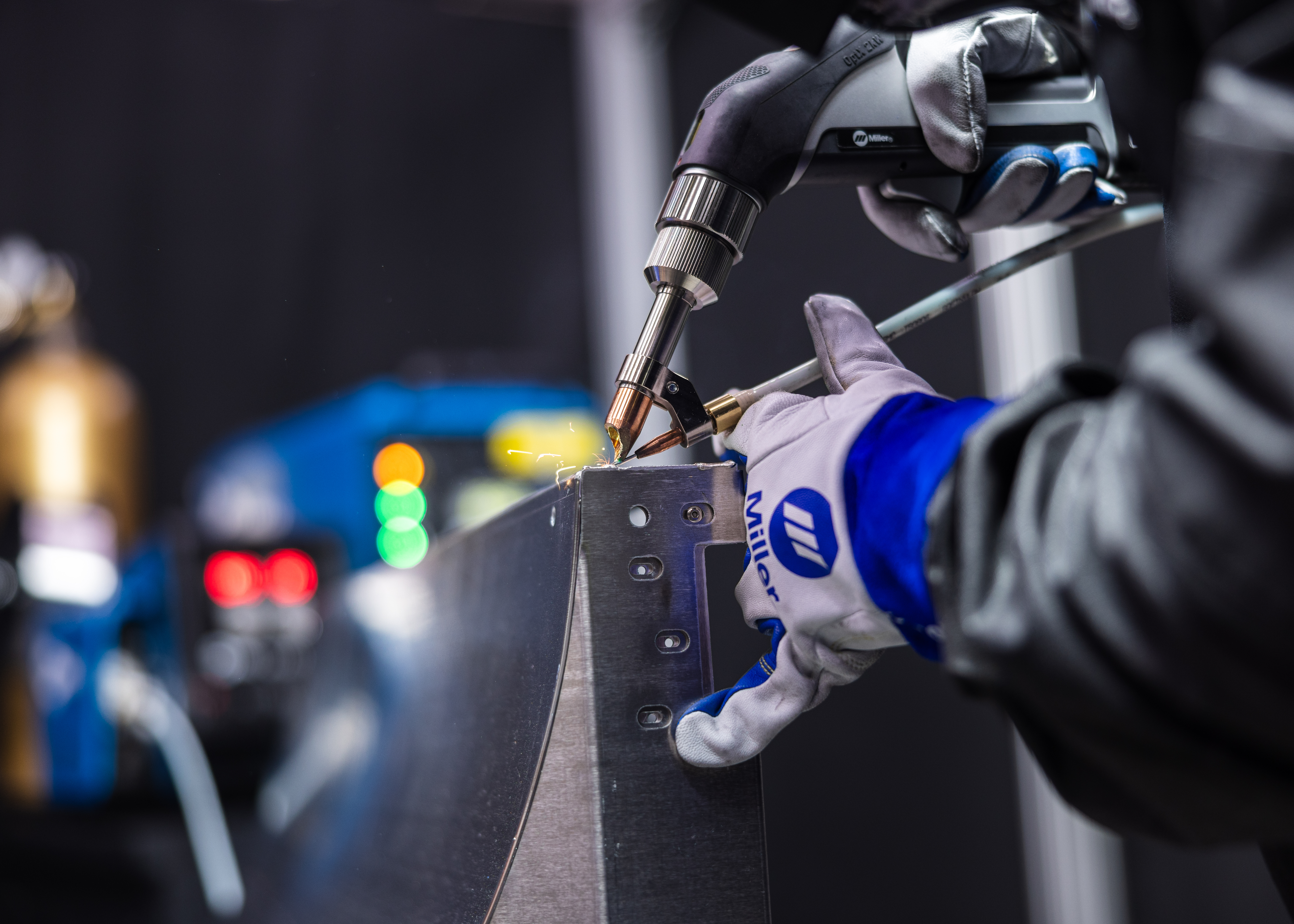

Improving Fit‑Up Tolerance in Aluminum Laser Welding
Laser welding has traditionally been associated with tight joint tolerances — something that can be difficult to achieve consistently with aluminum components. Small gaps can disrupt fusion if the process lacks flexibility.
Modern systems address this through advanced beam control and coordinated wire delivery that broaden the effective weld pool. These capabilities expand tolerance for minor fit‑up variation, giving shops greater flexibility when working with aluminum parts that may be difficult to fixture or vary slightly from piece to piece.

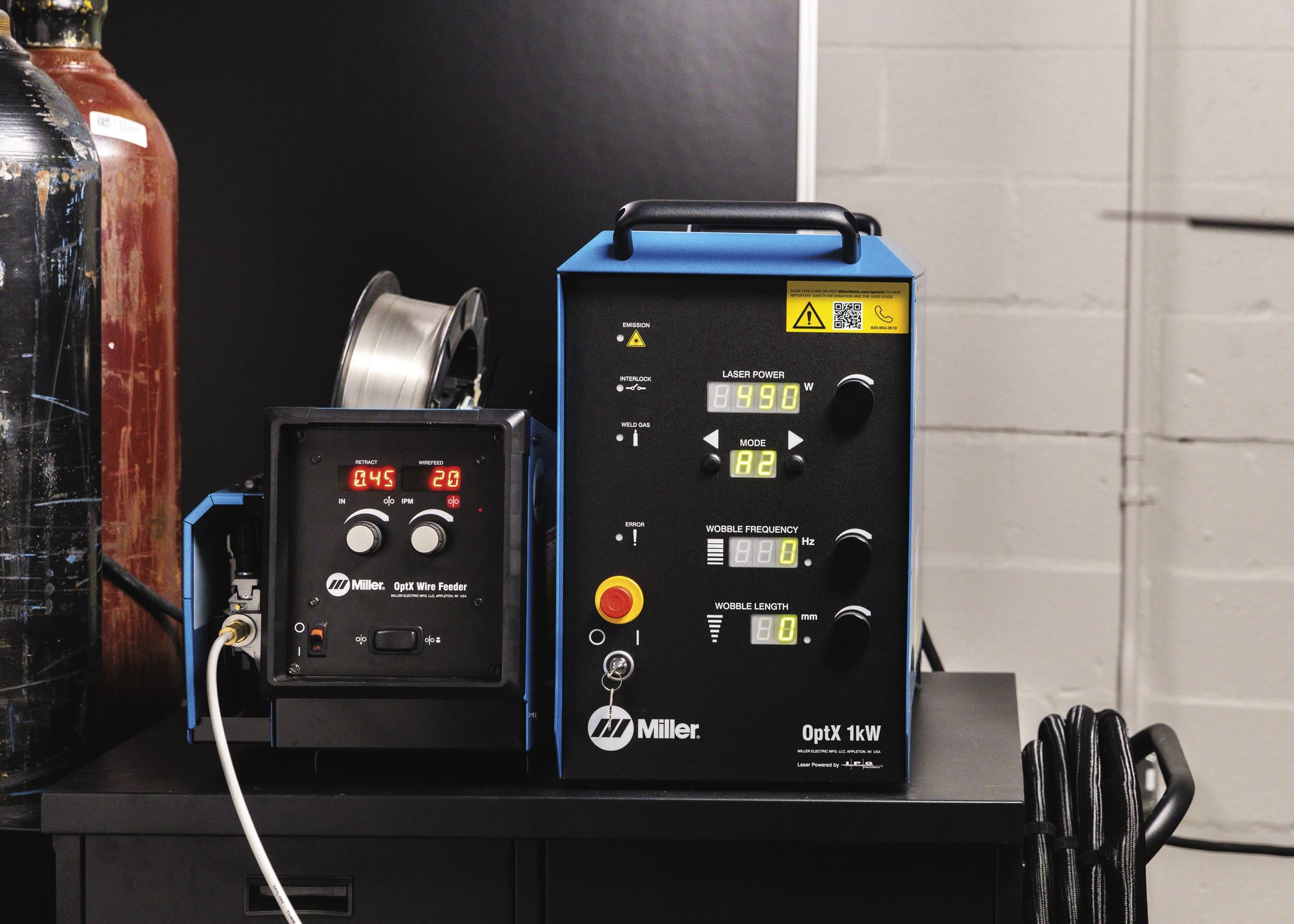

Pre‑Engineered Programs and Best Applications for Aluminum Laser Welding
One of the strongest confidence builders in modern handheld laser welding, particularly with systems like OptX, is the use of pre‑engineered programs for aluminum applications. With systems like OptX, operators select the appropriate aluminum material and penetration thickness from established charts, then choose the corresponding program and laser power settings.
This structured approach helps reduce trial and error and lowers reliance on manual parameter development while still requiring operators to follow recommended settings and validation procedures. Laser welding is particularly well suited for thin‑gauge aluminum, decorative components, enclosures and precision assemblies where appearance and dimensional control matter most.
