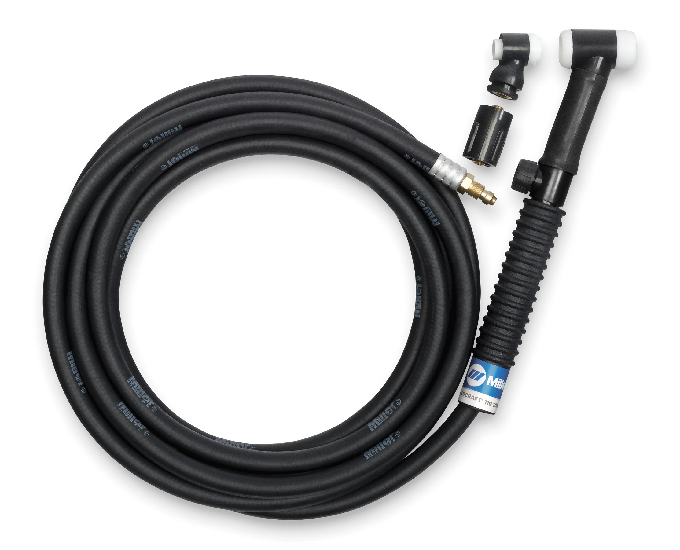

  • Configurable Head Options
    Easy configurable head options provide greater flexibility and joint access, and minimize downtime for torch changeover.

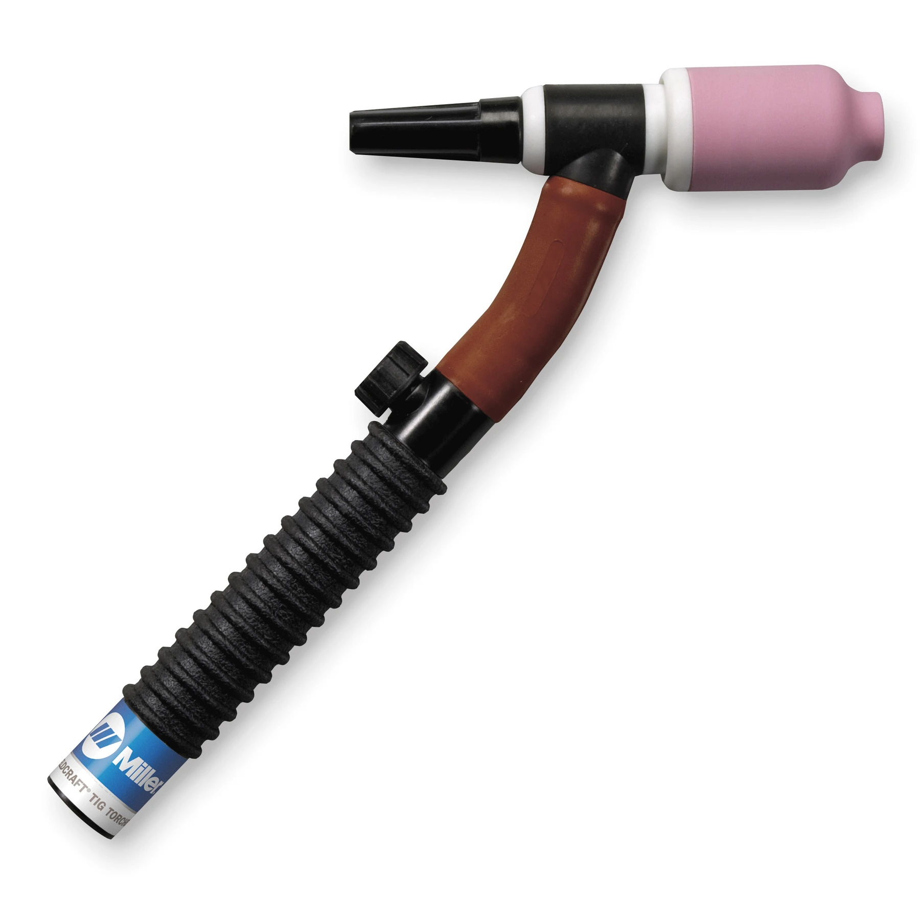

  • A-150 Modular Torch Heads
    Torch Head Angle (degrees) Electrode Range DC Amp Rating AC Amp Rating 24 70 .020-3/32 in. (0.5-2.4 mm) 80 50 24-90 90 .020-3/32 in. (0.5-2.4 mm) 80 50 9-70 70 .020-1/8 in. (0.5-3.2 mm) 125 100 9-90 90 .020-1/8 in. (0.5-3.2 mm) 125 100 9P 180 .020-1/8 in. (0.5-3.2 mm) 125 100 1726 70 .020-5/32 in. (0.5-4.0 mm) 150 115 1726P 180 .020-5/32 in. (0.5-4.0 mm) 150 115

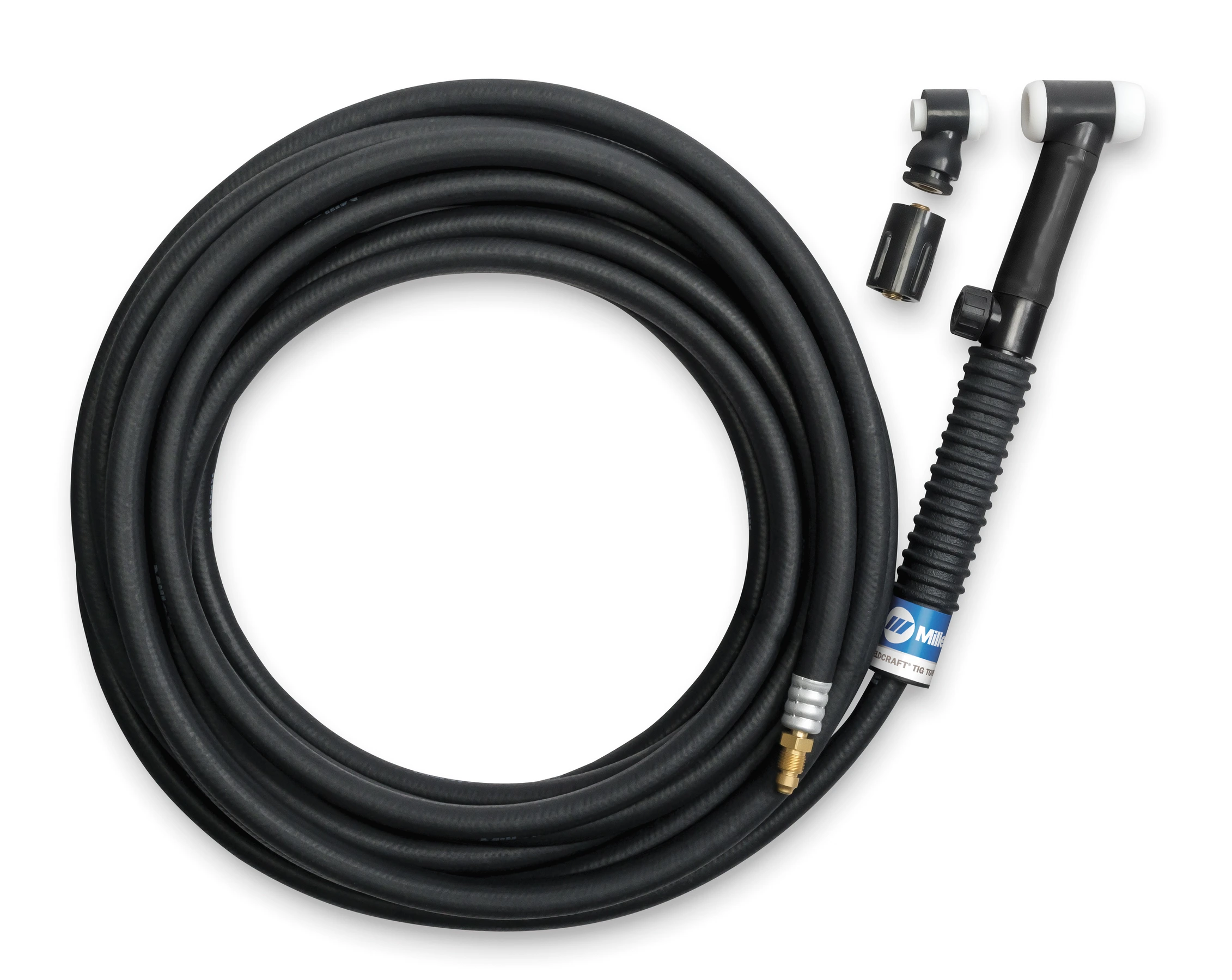

  • Gas Valve
    Provides greater shielding gas flow control.
  • Modular Design
    Minimizes costs and downtime for torch changeover and parts inventory.
