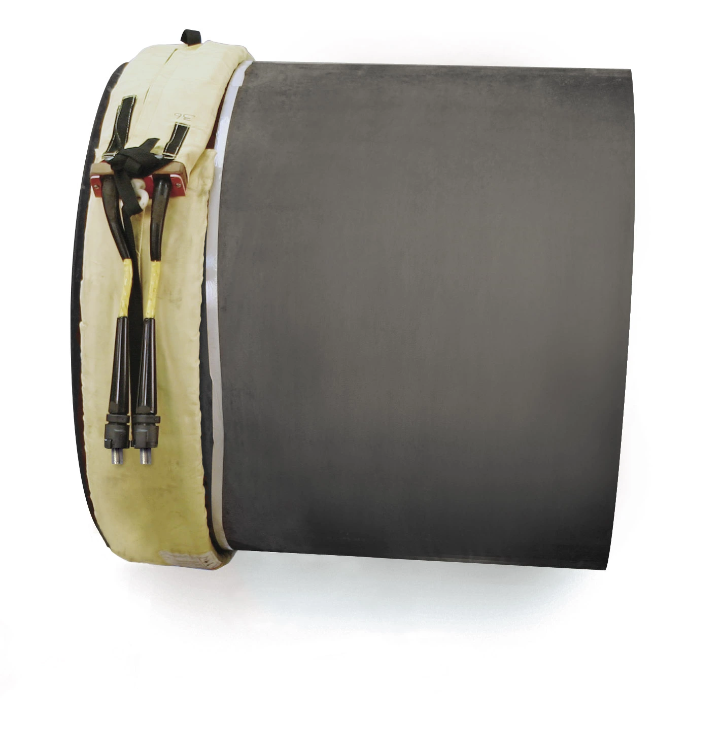

Induction Heating Blanket 9 in. x 110 in.
300067

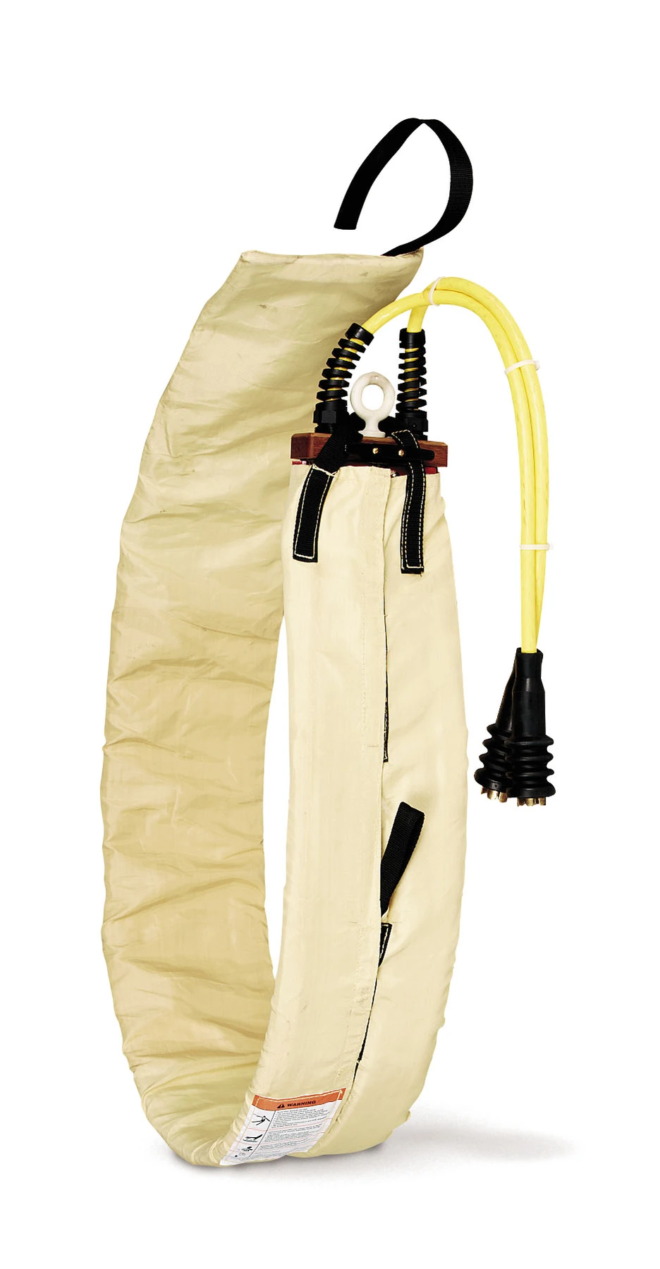

Replaceable Kevlar® sleeve
Each ProHeat Flexible Induction Blanket is supplied with a replaceable Kevlar® sleeve for added protection against abrasion, cuts and tears. Straight-forward installation with hook-and-loop Velcro® allows for trouble-free field replacement.
Air-cooled - 100 percent duty cycle
Rated for continuous operation at 400°F (204°C), all flexible induction Blankets feature air-cooling. By eliminating the need for water-cooling as used in conventional induction coils, the ProHeat Flexible Induction Blanket provides greater flexibility and reduced installation costs.
Twistlock connectors
Electrical connection to output extension cables is made though the use of durable twistlock connectors. Molded to the ends of wires extending from the blanket, these connectors assure that connection is maintained during handling and operation of the induction system. A plastic shell seals the connection from dirt, debris and moisture.
High operation efficiency
With an operation efficiency greater than 90 percent, the ProHeat Flexible Induction Blankets provide efficient preheat performance for thin or heavy-wall part application.
