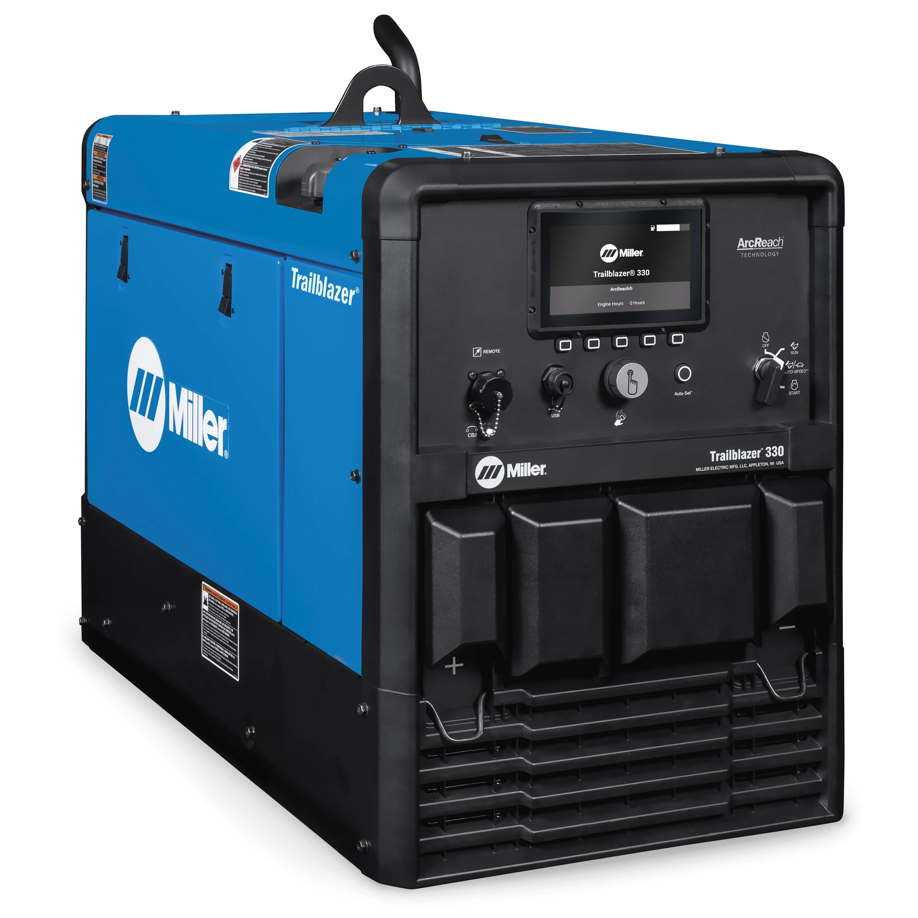

The Trailblazer 330 equipped with ArcReach®, Auto-Set™ and Auto-Speed™ technology is a versatile engine-driven welder that delivers a smooth, stable arc along with the power capabilities you need most often. ArcReach technology lets you change amperage and voltage from the ArcReach feeder or stick/TIG remote, Auto-Set™ technology gives preset parameters for fast and easy setup, while Auto-Speed™ technology matches engine speed to the load, so you get the welding power you need plus reduced fuel consumption and lower noise levels. Auto-Set™ technology delivers the speed, convenience and confidence of preset controls, making weld parameter setup fast, easy and accurate.
907831001 Trailblazer 330 Excel Power Lit Splash Screen
Trailblazer® 330

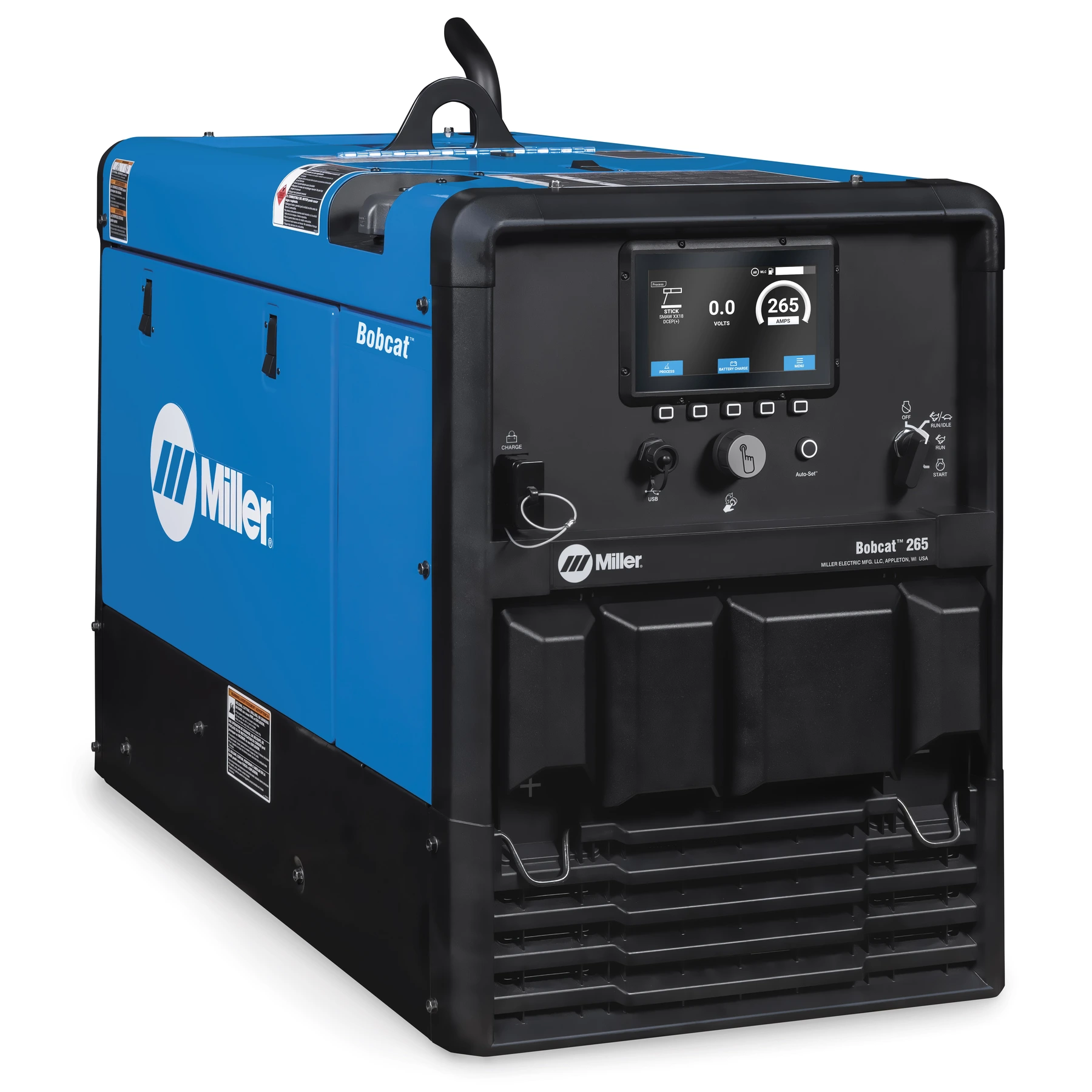

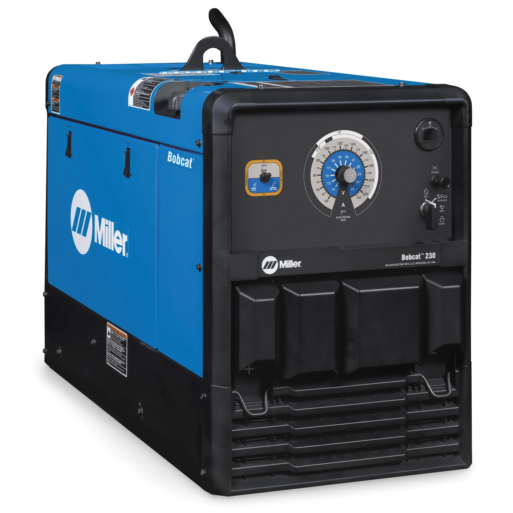

The Bobcat 230 provides 9,500 watts of continuous, clean and reliable auxiliary power to run the tools and lights that are critical to your job. If you need slightly more output to run larger stick electrodes, the Bobcat 265 offers the same auxiliary capabilities for powering tools with more welding power. With a compact and lightweight design, Bobcat engine-driven welders can be easily moved around the jobsite by truck, UTV or running gear.
Bobcat 230 Image
Bobcat™ 230
907826002 Bobcat 265 Battery Charging Lit Fully Featured Status Bar RF
Bobcat™ 265

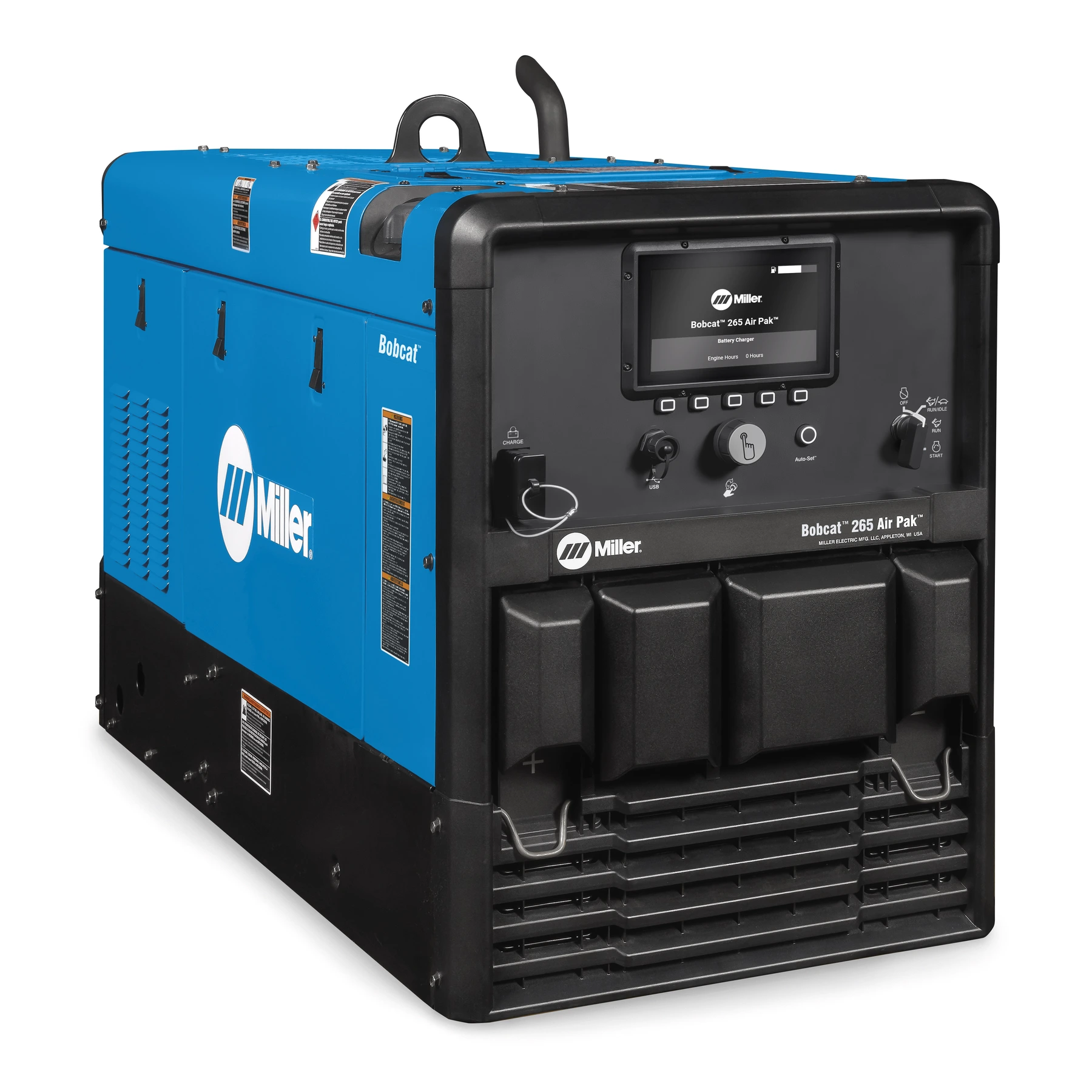

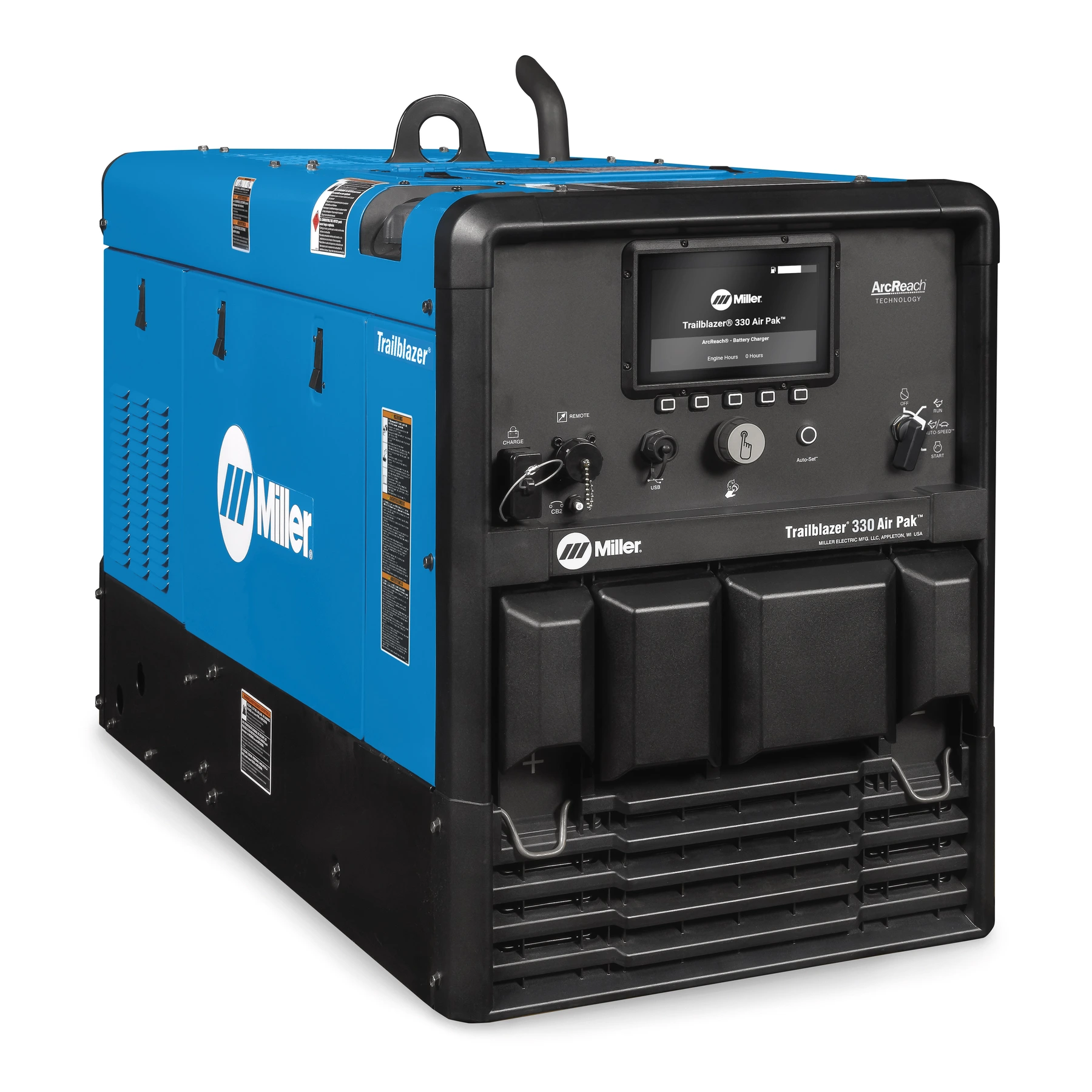

Both the Bobcat 265 Air Pak and Trailblazer 330 Air Pak offer the added advantage of an integrated industrial rotary-screw air compressor that eliminates the need for a separate compressor. These powerful all-in-one machines are lighter and smaller than previous models, offering multiprocess weld quality, auxiliary power, battery charge/crank assist and, now, an air compressor — delivering all-in-one capabilities for maintenance, repair operations and field fabrication. Both Air Pak machines allow operators to run air impact wrenches and give 100% deliverable air. The compressor produces 30 cfm of air at 100% duty cycle and delivers 80-160 psi of air with an optional storage tank for consistent airflow performance.
Trailblazer 330 Air Pak Excel Power Battery Charging Lit Splash Screen Model
Trailblazer® 330 Air Pak™
907876 Bobcat 265 Air Pak Lit Splash Screen
Bobcat™ 265 Air Pak™
