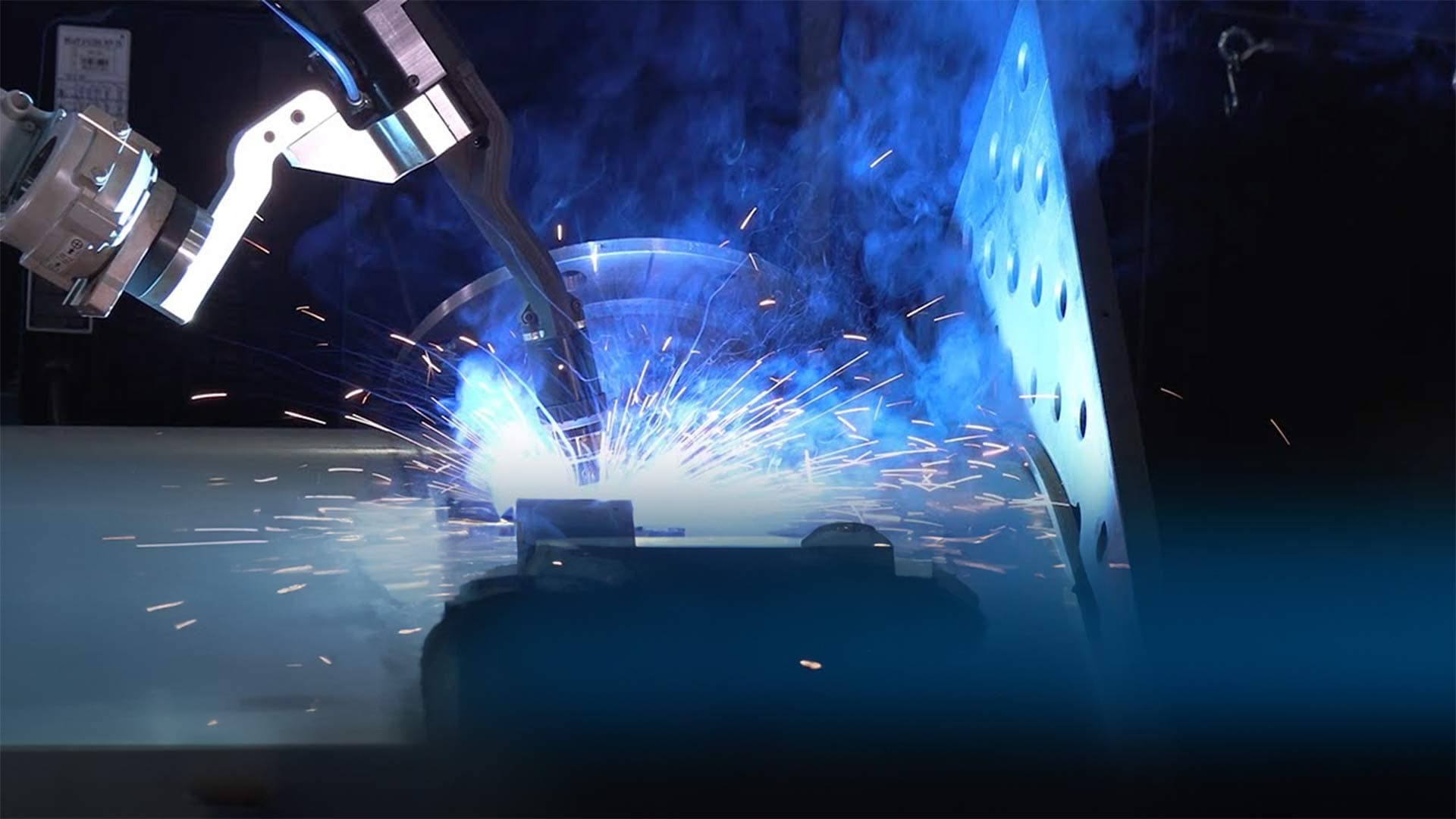

The new system that is available, however, takes a different approach to high deposition welding. The Hercules automated MIG welding system boosts productivity by delivering a gain of up to 30 percent and possibly more in deposition rates over a typical MIG welding system and corresponding productivity with no loss of weld integrity. It is for robotic welding with long welds in the flat and horizontal welding positions.

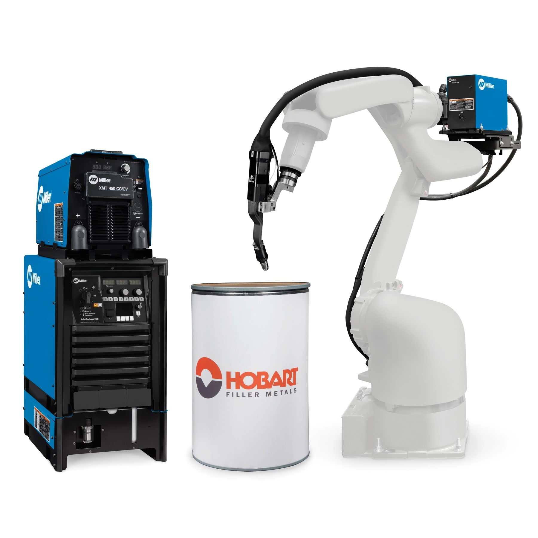

Four inputs are involved in making the Hercules welding system work effectively. Developed by Miller, Hobart and Tregaskiss, the system combines two power sources, a wire feeder, a unique torch design and a specialized metal-cored wire.
The Hercules system works well because the Miller Auto-Continuum 500 and XMT 450 CC/CV power sources work together with the Hercules Drive to deliver what the system needs.
“In order to get high deposition rates, say 20 lbs. and higher, you’re going to need higher amperages,” Perrin says. “Typically, for higher levels of deposition, you have to go up in wire size. Because you’re feeding more wire, you need more amps to maintain that arc.”
With the Auto-Continuum 500 establishing and maintaining the arc, it’s the second power source, the XMT 450 CC/CV, that provides one of the keys to the Hercules system’s success. “We’re doing something special where we have a secondary power source preheating the wire prior to it entering the welding arc,” Perrin says.
What are the benefits of preheating? Perrin explains: “To melt the solid-state wire and maintain that arc, you need a X amount of energy. It takes a certain amount of energy to take something from a solid state (in this case the wire) and turn it into a molten puddle. With the addition of preheating the wire prior to it entering the arc, we can reduce the amount of energy needed to melt the wire.
“The Auto-Continuum has a duty cycle of 500 amps,” he continues. “If we were to feed 650 ipm of wire without preheating, it would require 500 to 600 amps to sustain that arc. By preheating the wire, we can achieve the same wire feed rate while the Auto-Continuum only needs approximately 350 or 400 amps to maintain the arc. This preheating process allows for improved arc stability, resulting in a visually appealing and precise arc.”
Discover an integrated solution
Another part of the system is the Tregaskiss Hercules robotic MIG gun. The design of this system is tailored to seamlessly integrate with the two power sources. It incorporates two contact tips, each with distinct functions. The first contact tip operates in a manner similar to traditional welding processes, generating the welding arc. Positioned just before it, the second contact tip is responsible for delivering the crucial preheating element. Together, these contact tips work in tandem to optimize the welding process and achieve the desired results. Also, the gun’s water-cooled design delivers superior cooling to the front-end consumables.
The final piece of the puzzle is the Hobart FabCor Hercules gas-shielded metal-cored wire that can accommodate faster travel speeds to deliver the system’s high deposition rates and productivity while maintaining arc stability. The wire offers robust mechanical properties for heavy equipment applications where weld integrity, performance and aesthetics are key considerations. It maintains good bead appearance and contour, even when welding at high speeds. Summing up the Hercules system, Perrin says, “Every shop out there is optimized. Their current equipment and processes are optimized to their highest capacity. They can’t get any more out of them without deteriorating weld quality. So what can they do? Hiring more people might not be an option today, especially in more rural areas. And maybe they aren’t profitable enough to go out and purchase a new $300,000 automated cell. But they might have enough to invest in a Hercules system that can gain them up to 30 percent in deposition rates and even higher,” he adds. “It’s just giving the customer another tool and another option for automated robotic welding"
