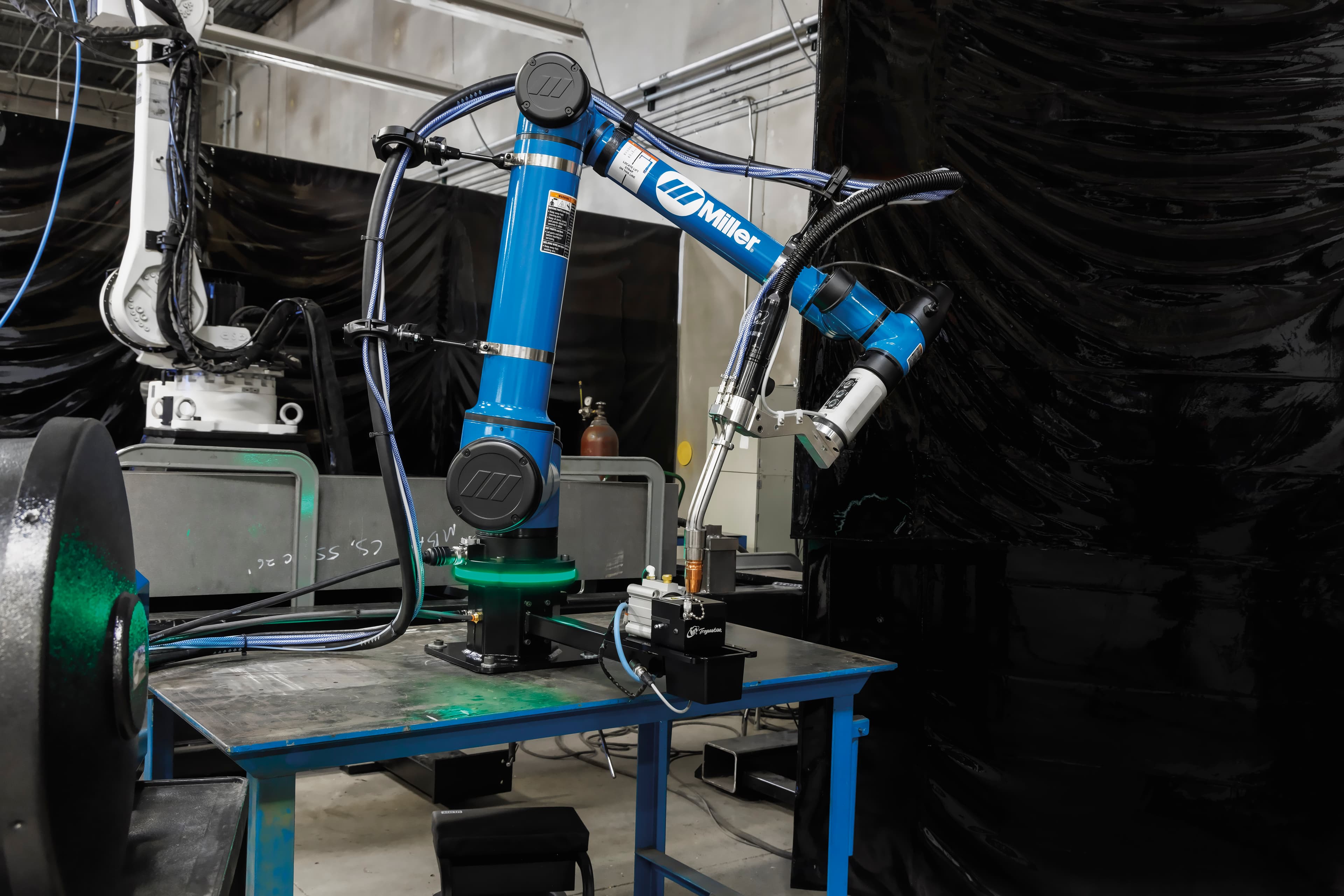

When bringing welding automation into the lineup, carving out the right space is essential. The Copilot comes standard on a large, robust 48" x 48" work table with 42" x 30" hole pattern. It supports up to a 1,500-pound payload capacity and has a tooling hole pattern that’s compatible with most modular fixturing. The table is easy to drop into a shop’s layout, and it can easily be moved and repositioned, with forklift pockets provided for transferring longer distances.
The Copilot Builder takes operational integration to the next level by allowing for greater flexibility in welding automation configurations. Often, workspace environments or product flow considerations create welding challenges unique to the shop’s floor. To adapt, the Builder system’s welding arm can be mounted however the application requires, including on a wall or track for the ideal configuration to tackle parts that are big or have complex and harder-to-access joints. All the critical pieces of Builder arrive on a portable pallet. The welding arm and other various components are ready to be detached and placed within the welding environment. Additionally, the wire drive can be rearranged, and optional cable lengths deliver even more freedom and customization.
