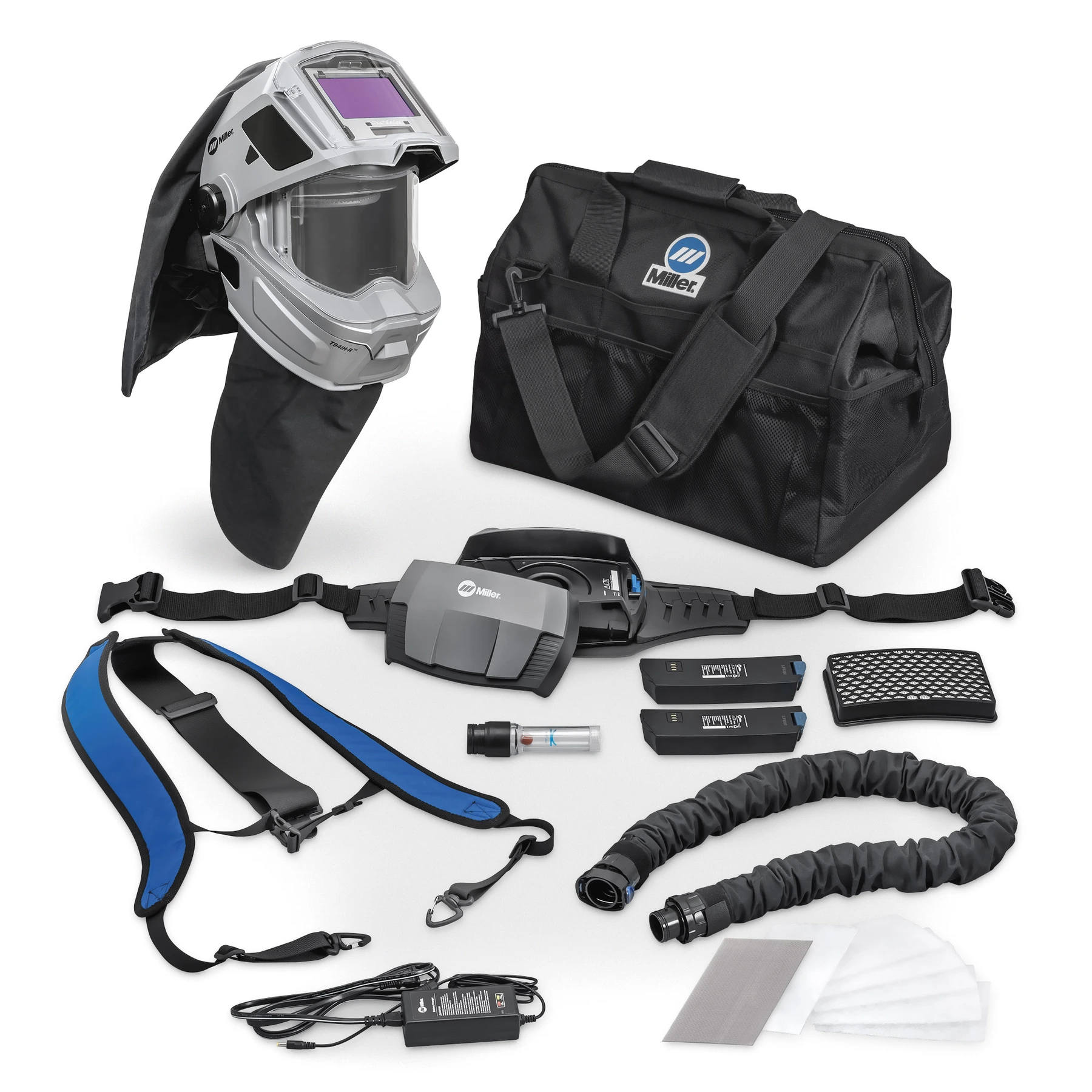

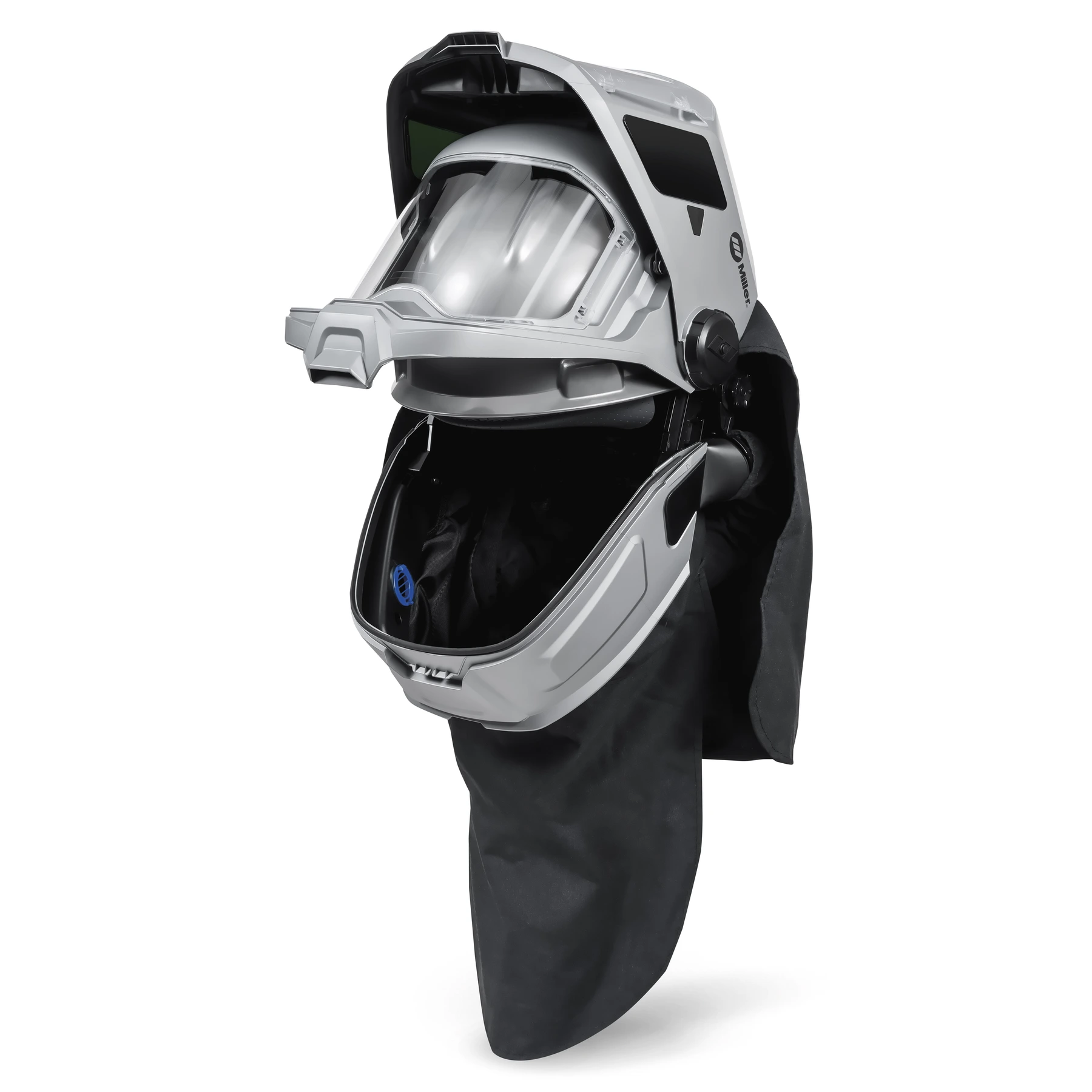

Blower features
Specially designed for comfort, convenience and high performance.
  1. Blower
    Lightweight and low-profile to extend wearability without interfering with surroundings
  2. Battery
    Two swappable lightweight lithium ion batteries provide up to 20 hours of battery life without carrying excessive weight (value of $340 per battery)
  3. Fan Speed
    Three fan speeds to adjust the volume of air to maximize comfort in varied work conditions

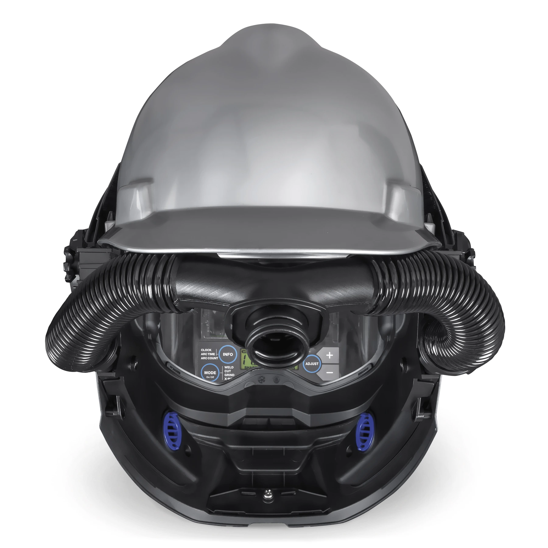

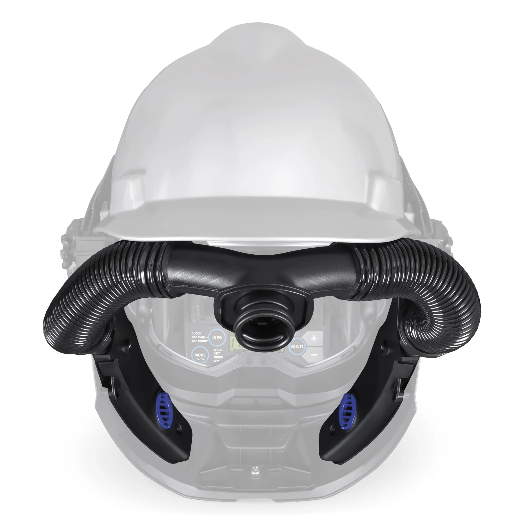

  4. Dualtec™ Manifold System
    Six adjustable air vents are optimally positioned to maximize cooling, and lower hose placement reduces neck strain
  5. Backpack Straps
    Integrated 3-point shoulder straps enhance comfort and reduce fatigue over long shifts

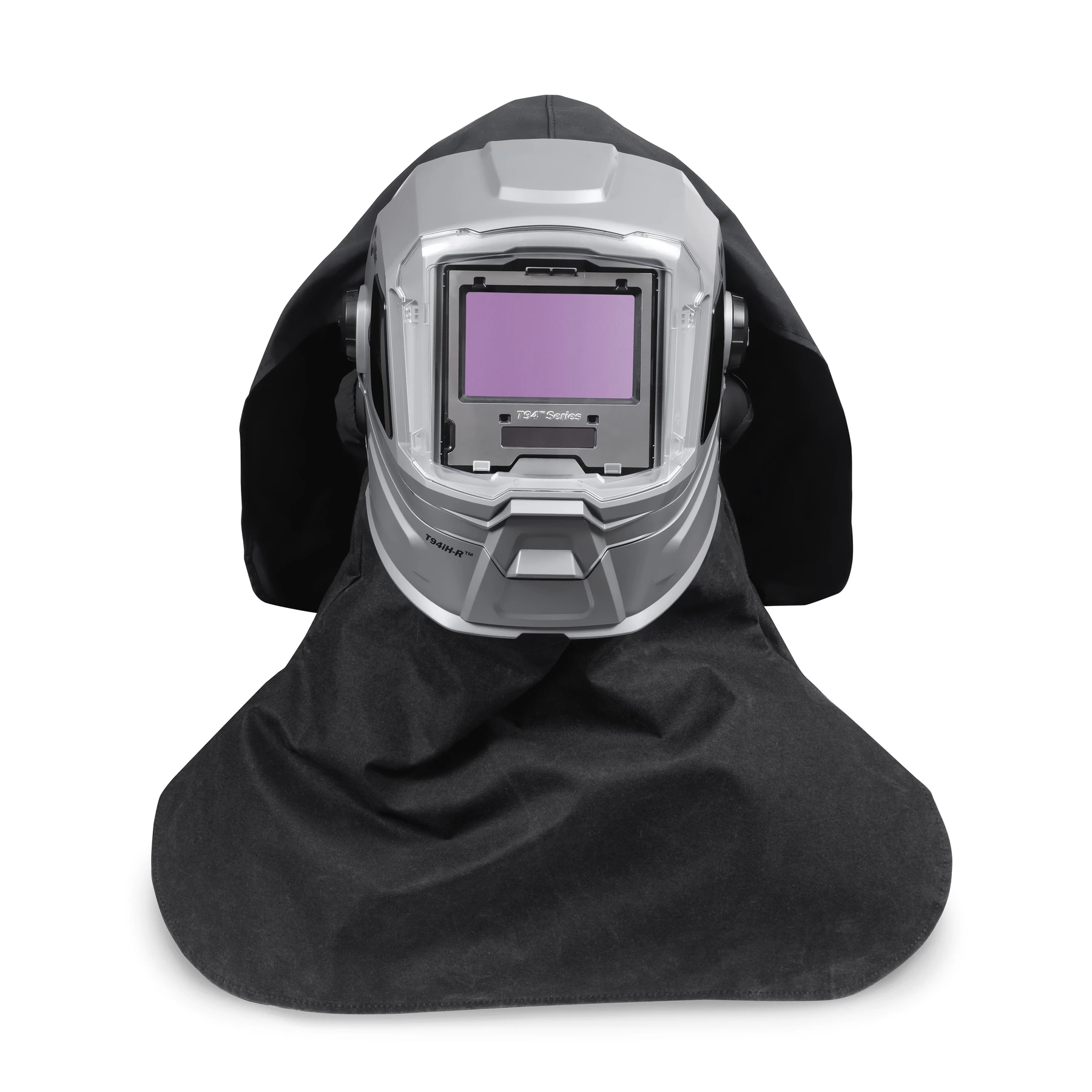

Lens Technology
Electromagnetically senses the weld to eliminate sunlight interference and continuously detects the arc.
X-Mode™

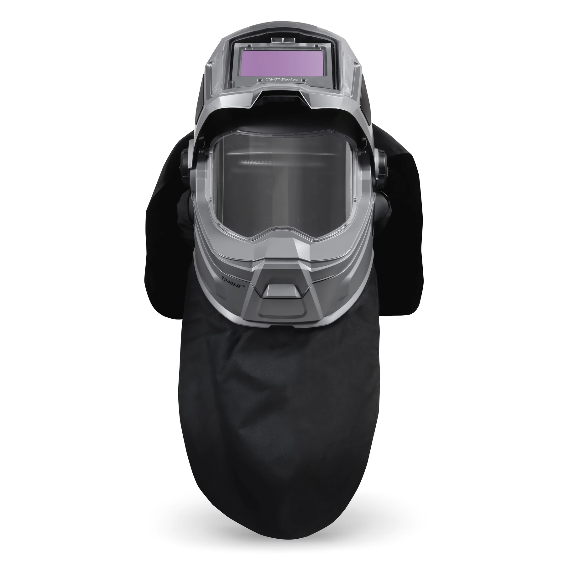

HDV
HDV ultra-clear cover plate and grind shield to eliminate distortion.
Memory Function
Allows you to easily switch between two preset customized memory settings.
InfoTrack™ 2.0
Exclusive arc tracking technology monitors arc time and arc count for quoting and metrics.
ClearLight 2_0 Dark State FNL
Lincoln 4C Dark State
Competitors with 1/1/1/1
ClearLight 4x™
Compare
When compared to ClearLight 4x, the 1/1/1/1 tech in other manufacturers’ helmets doesn't maintain the same level of visibility. Our brighter light state makes a valuable difference. Drag the slider to see the ClearLight 4x difference for yourself.

  • ClearLight™ 4x Lens Technology
  • Lift to Talk Head Assembly
    Improves communication, allowing operator to have access to face without removal of head assembly.
  • HDV Technology
  • Three Air Speeds
    Allow users to customize the volume of air to maximize comfort in varied work conditions.
  • Integrated HDV Grind Shield
    Large integrated grind shield provides 44 sq. in. of clear viewing area for grinding and other tasks, increasing helmet-on time, decreasing the potential for eye injuries.
  • MSA Fas-Trac® III Ratchet-Suspension Headgear
    Provides exceptional comfort, reducing pressure points while increasing stability.
  • LCD Display
    Allows users to see fan speed, filter timer, battery level and current time.
  • Four Operating Modes
  • Integrated 3-point Backpack-Style Shoulder Straps
    Enhance comfort, reduce fatigue over long shifts by distributing system weight to alleviate back pain.
  • Quick Release One-Piece Cover Lens with HDV
    Simplifies lens changes, reducing downtime
  • Lightweight Low-Profile Blower Design
    Extends wearability without interfering with surroundings.
  • Audible and Vibrating Alarms
  • Four Arc Sensors
  • Memory Function
  • Filter Timer
    Tracks how many hours of use the filter has.
  • InfoTrack™ 2.0
  • Shade 5.0 Side Windows
  • Flame-Retardant and Washable Standard Head Seal
    Enhances wear without causing skin irritation. Unique design can provide additional protection by covering the ears, or ease communication if placed in front of the ears.
  • Lightweight Lithium-Ion Battery
  • Half-Shade Lens Adjustability
    Provides fine shade adjustment for optimized comfort and vision.
  • Two Batteries
    Provide 20 hours of run time, decreasing down time
  • Dualtec™ Manifold System
