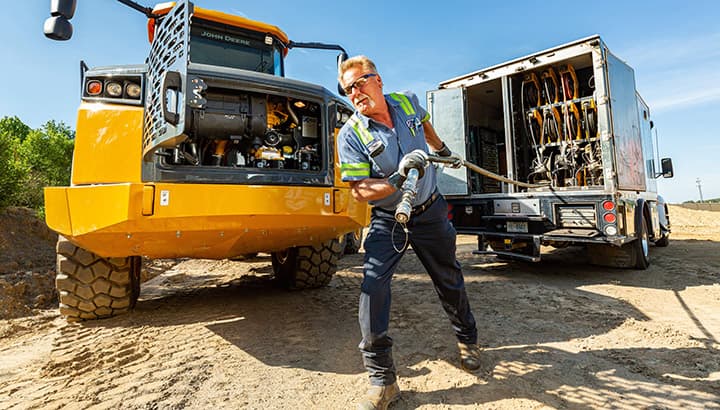

Vernon: I have a 2019 Peterbilt box truck. I have an all-in-one system on the truck and a heater in the back that runs from the fuel tank. That keeps the back of the truck warm in the winter. The oil flows a lot better and faster when it’s warm. If the oil gets cold, it gets thick and runs really slow. Inside the box truck I’ve got shelves for all the filters. I carry about eight different types of oil because each piece of equipment requires different types. I have tanks that hold anywhere from 200 to 500 gallons each.
John: I have a box truck with a PTO system and an air compressor, and it carries everything you could think of to do an oil change on heavy machinery. I have pumps that pump the fluid out of the tanks with the oil guns and a suction hose that sucks up the waste oil into the waste tank. Pretty much from the time I leave the house to the time I get home, that truck’s running.
Stewart: I have a Class C Peterbilt. It has tanks and I have an all-in-one system in the back.
