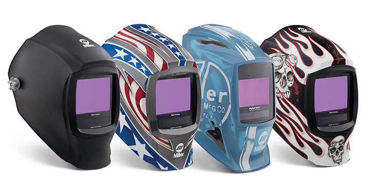

Helmets are a critical part of operator safety and protection in welding and grinding applications, but not all welding helmets are created equal.
There are a number of options to consider when selecting a helmet for a specific application or environment. Many types of helmets offer varying technologies and solutions that not only play a role in welding operator safety, but also impact productivity and comfort.
To select the right level of protection and product for the job, welding operators should consider the following: the amount and type of welding that is done; the need to perform alternate applications such as plasma cutting or grinding; whether out-of-position applications are required; and if welding will be done indoors or outdoors.
