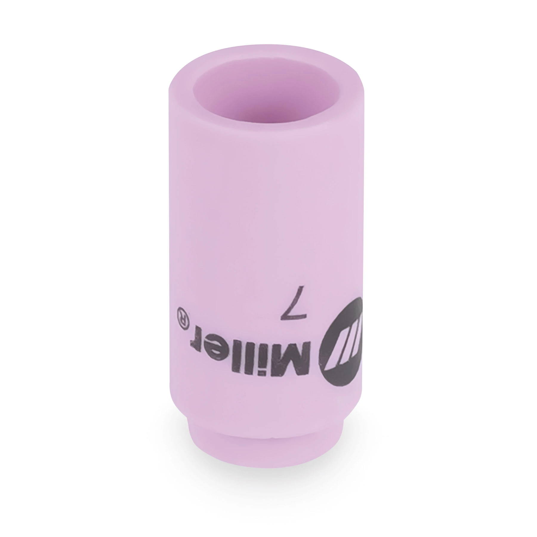

A ceramic cup shrouds the tungsten electrode, directing the gas flow. These cups come in several sizes for different welding applications.

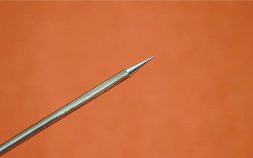

This is the tungsten electrode. It has been ground to a ball shape on one end and a point on the other. Each shape has its application. The tungsten is considered a consumable item and will be used up over time.

The tungsten should never touch the workpiece. When it does, you will notice a different sound and color, which means the tungsten is contaminated. Loosen the back cap and slip the tungsten (it is hot) out. Go to the grinder, preferably one with a wheel dedicated to tungsten, and clean the end of the tungsten. Reshape the end as necessary. You will dip the tungsten many times as you learn, but with more practice you'll be steadier and it will happen less.
