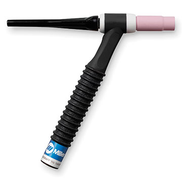

Air-cooled torches use the ambient air and shielding gas to dissipate excess heat. In addition, the power cable on an air-cooled torch contains more copper than the cable on a water-cooled torch to help prevent the cable insulation from melting or possibly burning. As a result, air-cooled torch cables are heavier and less flexible compared to water-cooled torch cables. However, air-cooled systems do not require an independent radiator cooling system and extra hoses that are associated with water-cooled systems. The simpler design of air-cooled systems make them easier to operate, assemble, maintain and transport.
Both air-cooled MIG guns and TIG torches are available in a variety of amperages for a multitude of applications. Air-cooled TIG torches are popular for applications equal to or less than 200 amps, but you can also find air-cooled TIG torches in 50- and 250-amp models. Air-cooled MIG guns are available in a wide range of amperages, between 150 and 600 amps.
The alternative to an air-cooled system is a water-cooled system. Water-cooled TIG torches or MIG guns require a radiator cooling system which circulates water through the head of the torch or gun and back over the power cable to dissipate heat from the torch or gun. However, water-cooled torch and gun cables are lighter and more flexible because the cable requires less copper compared to air-cooled systems.

Depending on your needs, the higher cost of a water-cooled MIG gun or TIG torch may be a viable investment. The flexible cable, lighter weight and smaller size of a water-cooled system provides more operator comfort. For example, the average 250-amp water-cooled TIG torch weighs approximately 3 ounces and measures about 6.5-inches in length, while a 150-amp air-cooled TIG torch weighs around 6 ounces and measures around 7.75-inches in length. If you are welding for an extended period of time, the greater weight of an air-cooled torch may increase operator fatigue and cause downtime.
