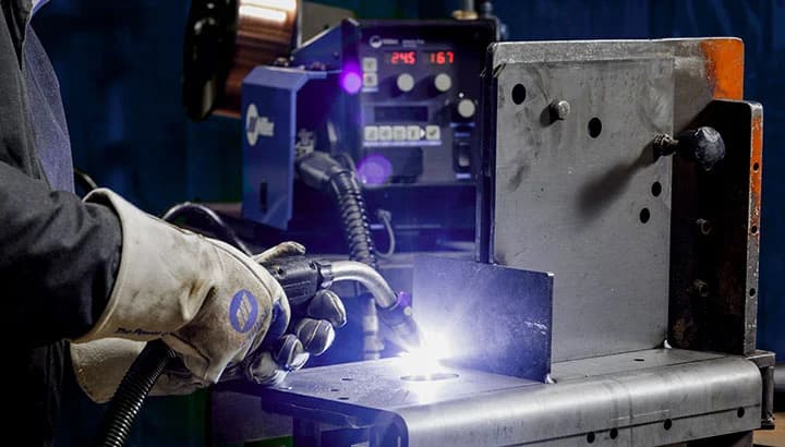

Ensuring the parameters are correctly dialed in during welding is critical to producing good welds that don’t require time-consuming rework. Travel speed that is too fast or slow, heat input that is too hot or cold, and improper wire stickout are parameters to watch.
A too-slow travel speed results in more heat input in the weld zone that can cause warpage. Maintaining adequate travel speed helps control heat. But moving too fast (and too cold) can pour too much filler metal into the weld too quickly. This results in spatter or a lack of penetration that requires rework. Another cause of increased spatter is having too much wire stickout.
When the goal is improving arc-on time, the worst thing a welder can do is put down a bad weld that requires rework. Cutting out the bad weld and replacing it with a new weld can triple the time spent — or more.
Troubleshooting problems like wire feeding issues takes away from arc-on time, so it’s important to keep the GMAW gun properly maintained for optimal performance.
If the gun liner or contact tip is too worn or the drive roll tension is improperly adjusted, these problems will contribute to wire feeding issues that can result in increased spatter and poor weld quality. Weld quality issues are also commonly caused by worn weld cables or poor cable connections.
Before each shift — and after any changes are made in the welding process — double-check all consumable connections in the wire feeding system. This ensures everything is installed and tightened correctly. Also look for signs of wear or damage. This helps reduce the time spent troubleshooting, so the welder can spend more time under the hood.
