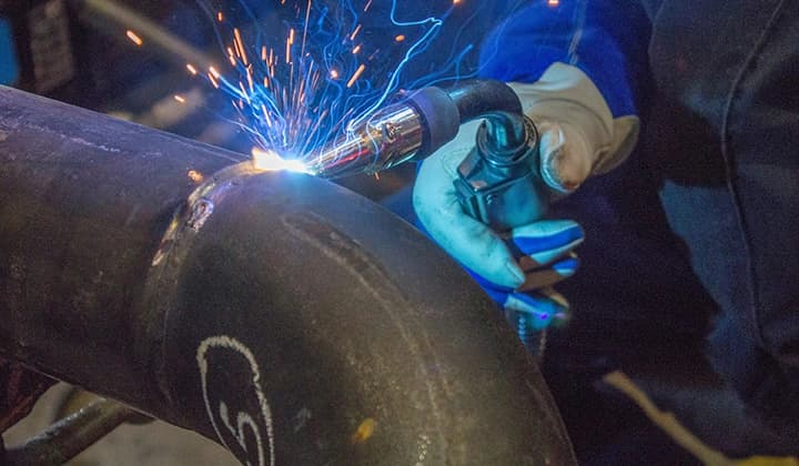

While TIG and stick welding are familiar processes in the field, wire welding processes can offer significant productivity benefits.
Switching to advanced welding processes, such as pulsed MIG or modified short-circuit MIG, is another way operations can improve productivity. These processes offer a more forgiving weld to help reduce weld failures. They can also reduce the necessary training time and make it easier for a welding operator to complete an X-ray quality weld on the root pass.
Using a modified short-circuit MIG process for the root pass offers the potential to eliminate the hot pass. This process (such as RMD®, or Regulated Metal Deposition) provides the ability to create a thicker root pass of 3/16 inch or greater. This is enough to support the heat input of pulsed MIG or flux-cored welding for the fill pass.
The faster travel speeds and higher deposition rates offered by these processes allow welders to complete code-quality welds in less time. For example, a 24-inch Schedule 160 pipe might take two days to stick weld with two operators. But with advanced welding processes, it can be completed in nine hours or less with one welding operator.
