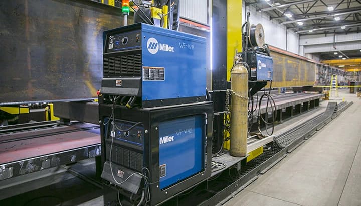

The company converted to an automated gantry system with submerged arc welding (SAW), and it’s been a game-changer for productivity. In fact, they are now saving up to 15 hours on each large overhead crane build. The welding gantry is a twin wire, dual weld head system that includes two Miller® SubArc DC 1000 Digital power sources that use Hobart® filler metals.

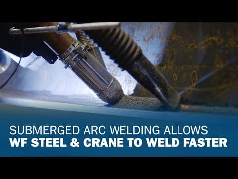

The company uses SAW for its overhead crane boxes because of the higher deposition rates and deeper penetration of the process. On crane projects, the company typically welds metals from 1/4- to 2-inches thick.
The shop was using a single-wire SAW process with a tractor that was not automated. The large crane boxes, which can be up to 150 feet long, had to be laid on their sides so each side could be welded separately. Because the heat was going to one side of the box, this caused the boxes to twist and warp, which required hours of post-weld work to heat treat and straighten the boxes.

In choosing the welding equipment to use in the gantry system, LJ recommended Miller SubArc DC 1000 Digital power sources because they integrate easily, which benefits communication and efficiency.
“Integration-wise, it was very easy,” Gratrix says. “If LJ Welding’s engineers had a choice, they would pick Miller SubArc on every system because of the compatibility. It’s seamless.”
WF Steel & Crane uses Miller equipment in other areas of the shop, so they trusted it would be a good choice for the automated SAW system.
“The Miller DC 1000 definitely has enough amps for the subarc, which was a big concern because we’re running twin wire, so we needed a big enough power source to run it,” Jacobson says.

Because both sides are welding at once, the gantry system helps control heat input to reduce distortion of the beams. In addition, using twin wires on each side greatly increases deposition rates — more than doubling them from the old system.

Previously, a 100-foot beam may have taken 12 hours to weld and four hours or more for heat treatment and straightening. Weld rates using the single wire and SAW tractor were 10 to 12 inches per minute.
With the new gantry system and automated SAW process, that same job can be completed in one to two hours. Using twin wires on each welding head results in a weld rate of 30 inches per minute.

Installing and fine-tuning the gantry system also required finding the right wire and flux combination. WF Steel & Crane tested metal-cored wire options before selecting a Hobart EM12K solid wire. They use Hobart HA-495 flux for welding category 4 steels and Hobart SWX-120 flux for welding other materials.
“The slag release was the biggest thing,” Jacobson says. “The cleanup time was great, it had a smoother appearance on the weld. Once you find the right combination everything kind of falls into place where you have good weld appearance, easy slag release.” The flux delivery and recovery system used by WF adds further efficiency to the gantry solution by minimizing flux changeovers.
