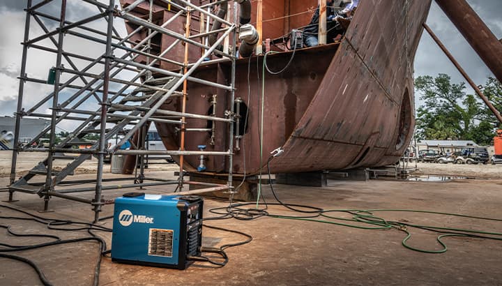

The diverse welding processes that shipbuilding requires present numerous challenges. One of the biggest obstacles is that ship welders often must navigate through extremely tight and confined spaces.
In the beginning stages of constructing a ship, its hull is welded from the outside, giving welders relative freedom to move around as needed while they work. On the inside, however, the spaces get more constricted as the various components are built up, e.g., stairwells, passageways and access areas for plumbing, electrical elements and more. In many cases, welders are working in spaces no bigger than a conventional manhole cover — a narrow 24 inches in diameter — and these tiny spaces are the norm for many maintenance tasks as well.
While many of these tight or difficult-to-reach spaces don’t fall under OSHA’s confined space standards, they’re still difficult jobsite environments. Ship welders often work in spots that can only be reached by ladder or scaffolding. They may need to crawl into or through small spaces to get to their weld. And when they do reach their worksite, it might be hard for them to get into a comfortable position or use proper technique — which can make it difficult to produce high-quality welds.
In addition to the safety challenges that make it tough for welders to reach and work in these spaces, there’s also the need to maintain a safe work environment — specifically around heat risk and fume extraction. Regarding ventilation and fume extraction, the recommended way to determine adequate ventilation is to sample for the composition and quantity of fumes and gases to which personnel are exposed. In some shipyard environments, portable fume extractors such as Miller® high-vacuum FILTAIR® 215 and FILTAIR® 130 fume extraction guns are utilized, while others employ industrial blower units to circulate clean and cool air throughout the confined areas. In terms of PPE, powered air purifying respirator (PAPR) systems can also be relied on to enhance respiratory protection.
Fume extraction concerns are prevalent even when spaces aren’t confined. Shipyards in California, for example, are required by the California Environmental Quality Act to capture all the weld fumes they produce, including welds being performed in the open air.
Proximity to a welding power source is also a concern. On some jobsites, a welder might be working hundreds of feet from their power source — requiring them to stop welding and walk back to the machine every time a parameter or process change is needed. This is especially tricky when welders find themselves in tight spaces and must crawl on their hands and knees, up and down ladders, and through manholes or narrow pathways to get to the power source.
The lost time adds up, and with it, labor costs increase. This is why many shipyards are now using remote-controlled welding technologies, such as Miller ArcReach® technology, to minimize the time spent getting to the power source while maximizing arc-on time, weld quality and jobsite safety. The ArcReach system allows welders to adjust their parameters at the weld joint versus having to make the journey back and forth between the power source, restoring up to 250 hours per operator per year lost to walking (not to mention the safety risks navigated while walking).
