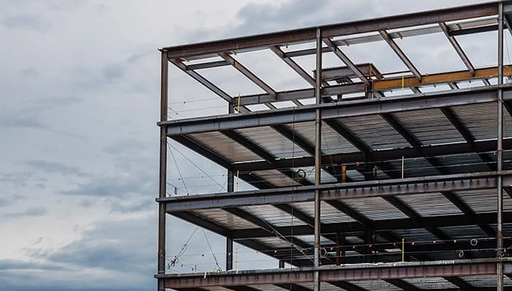

The day-to-day challenges on a construction jobsite can take up a lot of time and attention. A shortage of experienced workers, demanding project deadlines and costly welding rework are all factors that affect how quickly you can finish one job and move on to the next.
One common jobsite struggle that may fly under the radar — even though it can be an everyday hassle — is voltage drop in weld cables and the problems this can cause.
Learn more about what causes voltage drop and how one technology can help make welders’ jobs easier and reduce this problem on construction jobsites.

Long weld leads: On large construction jobsites, weld cables can be hundreds of feet long and strung out over several stories. Even when weld cables are correctly sized, if they are long this will cause more voltage drop. Try to upsize to a larger size cable to help reduce voltage drop on long leads.
