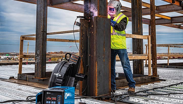

Technology on welding systems from Miller removes the hassle and guesswork from switching polarity. This improves jobsite safety and saves time so operators can spend more time under the hood with fewer distractions.
XMT® 650 ArcReach® Systems and XMT 350 FieldPro™ systems are both available with polarity reversing models. With these systems, operators can switch polarity and switch between welding and gouging easily from where they are working — eliminating the need to walk to the power source and swap cables.
The operator simply pushes a button on the front panel of the wire feeder or stick/TIG remote to choose the process they want to use. The system automatically chooses the correct polarity — either DCEN or DCEP — for that process setting. The polarity change is made internally within the power source, so there is no need for operators or helpers to connect or disconnect cables.
To take advantage of this time-saving technology, both the welding power source and the wire feeder or stick/TIG remote need to have ArcReach technology, which is what makes the automatic polarity switching possible.
