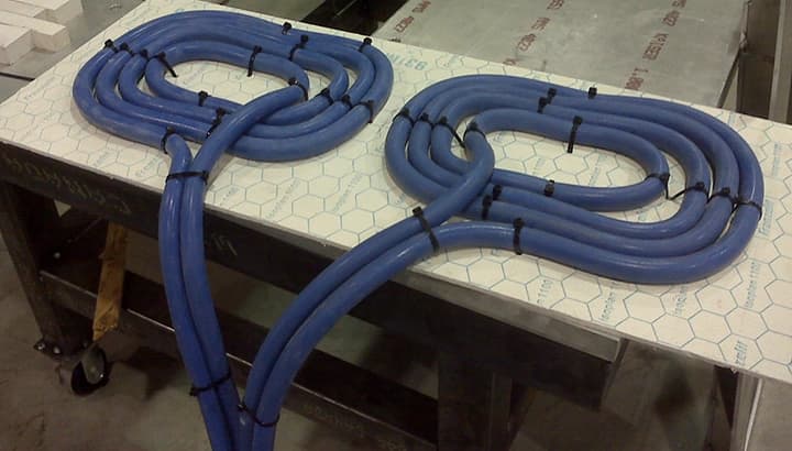

In induction coil design, a solenoid or helix coil is one that is typically wrapped around the part. A pancake coil — which looks similar in shape to a stovetop heating element — can lay flat on the part and be stretched out to cover a large area. In flat plate applications, operators will typically use a pancake coil or an induction blanket.
Users can shape induction coils to fit small, confined areas, and can also spread them over a large area to bring a larger workpiece up to temperature. For example, you can use one one long coil to heat a 40-foot steel beam. In addition, operators can use insulation or magnetic clamps to hold the pancake coil against the flat plate — useful in applications where the workpiece is vertical.
Induction coil configurations can also be used to heat from one side of the part in flat plate welding applications. So, for example, if the welding operator is working on one side of the plate, the induction coil can be heating from the opposite side. This allows induction heating and welding to occur at the same time, while also saving time in setup and in moving on to the next part. It also provides benefits for operator comfort.

Winding the coil
Take the time to properly wind the coil on the part. Improper winding of the coil can result in not having enough power for the heating requirements. For the best results, the turns of the coil should all be in the same direction — either all clockwise or all counterclockwise, for example. Avoid coil turns that are a 180-degree angle or in zig-zag configurations. Any unused portion of the coil — such as the ends — should be twisted or tied together to reduce the amount of heat losses in the unused portion of coil.
