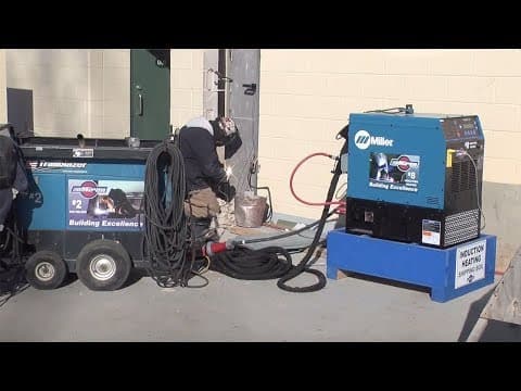

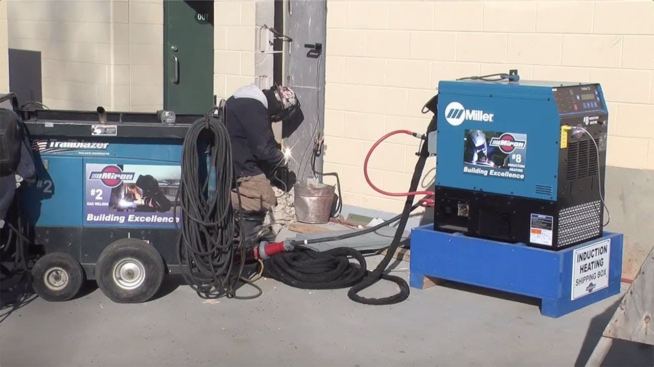

With the ProHeat™ 35 induction heating system from Miller, Miron Construction was able to bring each column or cap plate to temperature, leave the induction heating coils in place, and make the complete weld without stopping (except to switch out stick electrodes). This saved a substantial amount of time and provided uniform heating throughout the weld area.
“The induction heating system has actually been great for plating the columns and welding on the side,” explains Jake Wirkuty, an ironworker with Miron Construction. “It saves a lot of time on the preheat setup. Instead of welding 3 inches, preheating and then welding 3 inches, it’s been excellent just to slap the coil on the side of the column. We have an 8-foot setup, which, with two guys, one on each side of the column welding and keeping that temp up, it saves probably half the time or more of preheating.”
An induction heating system creates heat electromagnetically in the material rather than by surface heating, as with an open flame. Heat is induced by placing the steel in an alternating magnetic field created by liquid-cooled induction heating cables. In this application, Miron Construction rigged an 8-foot-long strip of plywood with the induction heating cables so it could be quickly and easily placed along each 2 1/2-inch thick reinforcement plate. The induction cables do not heat up themselves, but create eddy currents that generate heat throughout the plate and column. Two welders then worked down the side of each column plate.
“What we ended up doing with the coils for the unit was taking an 8-foot sheet of plywood, cutting it down to the size of our column plate, and zip-tying our coils to it and clamping the plywood to the edge of the column,” says Wirkuty. “When that side is done and heated, you just unclamp it and move to the other side. It makes it very easy to get around.”
