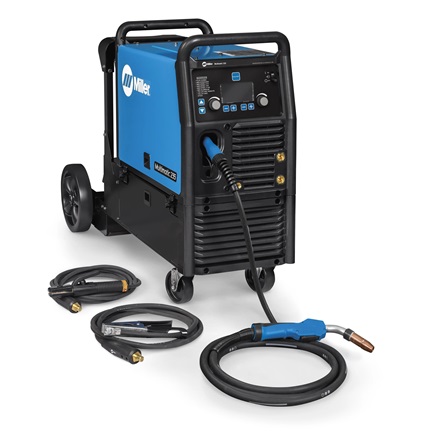

Multimatic® 235 Multiprocess Welder - 240V
907780
DC TIG, MIG, flux-cored, and stick welder featuring Auto-Set™ Elite. 240V input power.

What's Included
  • Power source with 7 ft. (2.1 m) power cord
  • 15 ft. (4.5 m) 250-amp MDX™-250 MIG gun w/ Bernard® AccuLock™ MDX consumables for .030/.035 in. (0.8/0.9 mm) wire
  • 10 ft. (3 m) cable w/electrode holder & 50 mm Dinse-style connector
  • 10 ft. (3 m) work cable w/clamp & 50 mm Dinse-style connector
  • Flow gauge regulator and gas hose for argon or AR/CO2 mix
  • Extra contact tips
  • .030/.035 in. (0.8/0.9 mm) reversible drive rolls
  • Material Thickness Gauge

Portability - Machine only weighs 63 lb
Weight is reduced to make it easier to take the welder to where the work is, plus the added convenience of one machine versus two or more.
