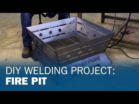

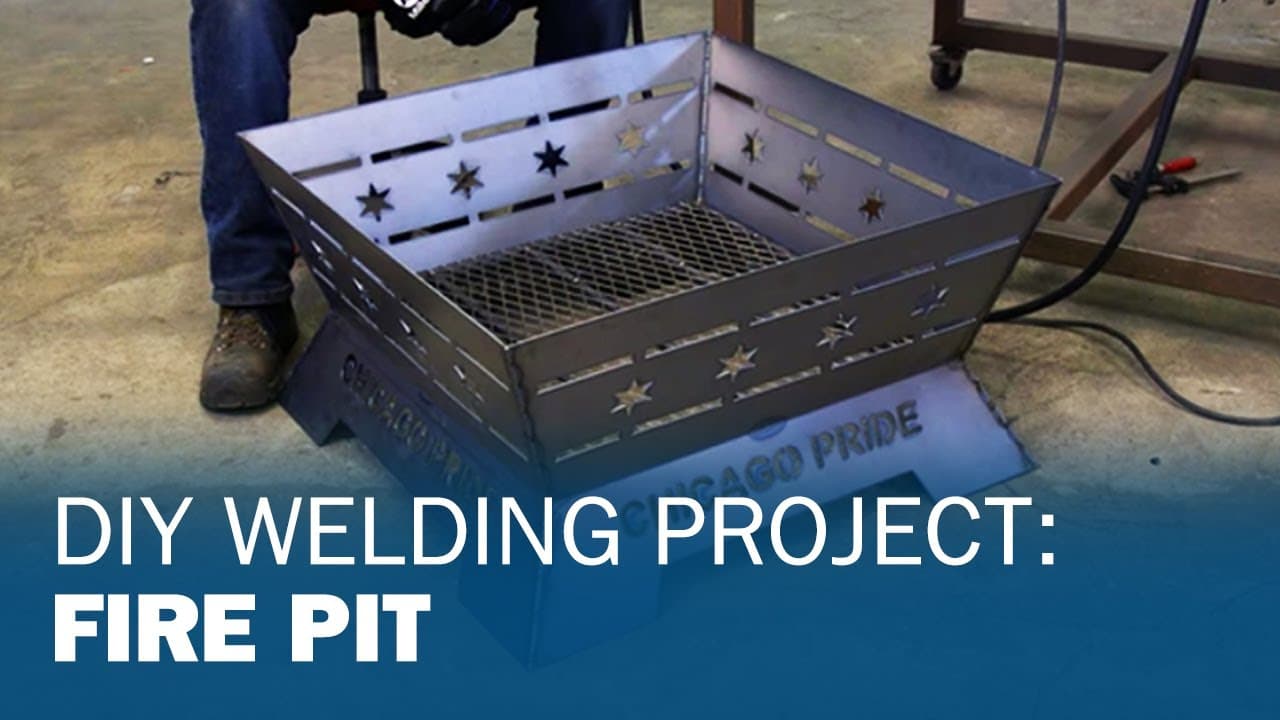

DIY Welding Project: How to Build a Fire Pit
The perfect addition to any backyard, a fire pit invites festive gatherings all year long. You’ll be proud to host the next get-together and show off a metal creation that you built to last.
Fire Pit Project Plans
Tools and Materials
  • Multimatic® 215 (or other MIG or flux-cored welder, minimum 140 volts)
  • MIG or flux-cored wire
  • Spectrum® 625 X-TREME™ (or other plasma cutter, minimum 15 amps)
  • 4.5-inch angle grinder (with 40-grit flap disk)
  • 16-gauge hot rolled steel sheet, 4 (4' × 8')
  • 1/2-inch hot rolled square bar (minimum 18')
  • Steel expanded grate, 1 (2' × 2')
  • Optional: Metal brake
  • Optional: Hammer
  • Optional: Pliers
  • Optional: Clamps
  • Optional: Magnets
