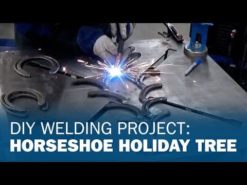

Turn old horseshoes into a festive holiday decoration with this beginner-friendly DIY welding project. Follow step-by-step instructions to create a unique horseshoe Christmas tree using simple welding techniques and shop tools.

Tools and Materials
  • MIG welder
  • Drill and 7/64" or other small drill bit
  • Wire brush
  • Metal cutting tool (band saw, reciprocating saw, abrasive cutoff wheel or hacksaw)
  • Grinder, disk or belt sander
  • Marker
  • Tape measure
  • 6 used or new horseshoes (5 of one size and 1 larger for base)
  • .030" ER70S-6 MIG wire
  • Rust remover or white cleaning vinegar
  • Bucket to soak horseshoes in
  • Green spray paint and white textured spray paint
  • Assorted small ornaments
