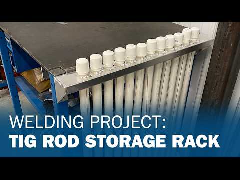

Keep a variety of TIG rods organized and close at hand with this handy TIG rod storage solution.
TIG Rod Storage Rack Project Plans
Tools and Materials
  • Multimatic® 220 AC/DC multiprocess welder
  • .063 3003 alloy aluminum
  • 1/16" 4043 filler metal
  • 1" PVC pipes, cut to 36" length (Qty. 12)
  • 1" PVC end caps (Qty. 24)
  • Stomp shear, band saw or reciprocating saw
  • Hole punch or hole saw
  • 1/8" drill bit
  • Drill or drill press
  • Sheet metal brake or bending tools
