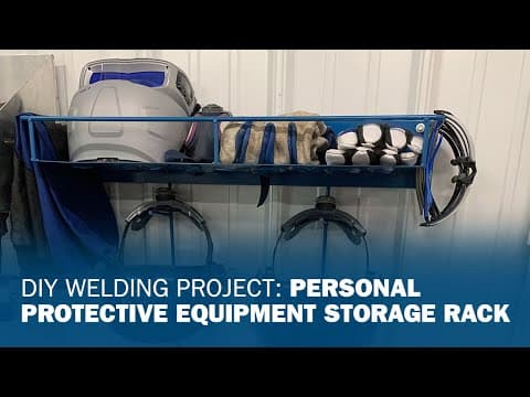

The proper Personal Protective Equipment (PPE) helps you safely complete projects in your shop or garage. Keep your PPE organized and handy with this DIY storage rack.
PPE Storage Rack Project Plans
