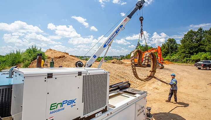

The EnPak® A60 all-in-one from Miller offers several technologies and design advancements that deliver the power and performance needed for optimized hydraulic operation on the jobsite.

Operators can modulate their crane better and get more stable performance with the pump design of the new EnPak® A60. An electronic flow control valve has been integrated into the pump, so it is better able to react to system demands. This feature is exclusive to the EnPak® A60 among all-in-one systems. By integrating the flow control into the pump, power loss due to pressure drops have been reduced, which allows for a more efficient system. By reducing this loss, the EnPak® A60 design delivers more power and the engine doesn’t have to work as hard, which provides more power for other operational functions.
There is much variability among work truck configurations and system design that can affect crane performance. But the technologies and features of the new EnPak® A60 deliver big benefits for hydraulic crane speed and performance.
