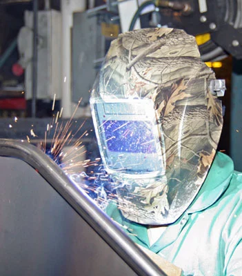

Tip #7: Auto-Darkening Helmets
The sensors on an auto-darkening helmet darken the lens in a fraction of a second. All auto-darkening helmets must meet ANSI standards, the most recent being ANSI Z87.1-2003.
Industrial grade helmets react at speeds of 1/10,000 to 1/20,000 of a second and have adjustable shades settings of #9 to #13 for welding. Industrial grade helmets also have adjustable sensitivity (useful for low amperage welding) and delay controls to adjust how long the lens stays dark after the arc stops.
Newer helmets have different modes, allowing the same helmet to be used for welding, cutting and grinding. The most recent development is a mode that senses the arc electromagnetically, offering full protection when the sensors are obstructed, as when pipe welding or welding out-of-position.
Avoid auto-darkening helmets that darken with a reaction time of 1/2,000 to 1/3,600 of a second. This is not adequate for industrial applications. Further, cold weather delays the reaction time on all auto-darkening helmets. Higher-end helmets are rated for use down to 14 degree F. However, low-end helmets with slower reaction times may not darken quickly enough in cold weather.
vermeerhelmet000jpg
Auto-darkening welding helmets enable Vermeer to more easily adhere to production time goals, and they reduce operator fatigue. To encourage use, Vermeer splits the cost 50-50 with the operator, and the operator owns the helmet outright after three years

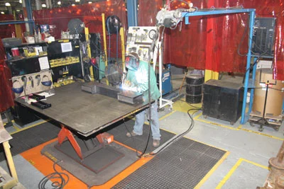

vermeerworkstationjpg
This station embodies Vermeer’s lean welding principles. Each tool and piece of equipment has its own, clearly labeled place. The weld table uses a scissors mechanism that presents the work to the operator at the appropriate height, which reduces stress, a potential source of operator error.

In its welding areas, Vermeer clearly labels and marks the place for each piece of equipment. There is a place for everything, and everything in its place. The weld area contains only the tools and equipment that operator uses; nothing more, nothing less. Rather than strictly using a fixed-height table, weld tables have a scissors mechanism that presents the work to the operator at the appropriate height.

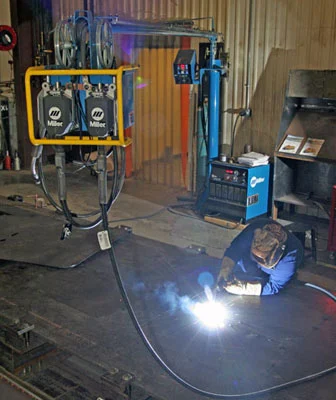

Tip #10: Use Boom-Mounted Wire Feeders
Boom-mounted wire feeders add flexibility, efficiency and operator comfort to high-production welding stations. Booms place the wire feeder controls at the base of a 12- or 16-ft. boom and the drive assembly at the end of the boom.
The boom rotates 360 degrees and moves 60 degrees up and down to create a 24- or 32-ft. diameter work area. A counterbalance holds the boom in place once the operator sets its position.
Cameron Miller, safety manager at Brookville Equipment Corp. notes that, “Boom-mounted feeders are ideal for us. Our goal is to create the safest workplace for our employees, and that includes limiting trip hazards created by cable clutter on the floor and eliminating the lifting of feeders, which may be loaded with up to 120 lbs. of wire. We weld in a variety of positions, from on the floor to up on the locomotives, so we needed a versatile yet clean set-up. With boom-mounted feeders, not only can our welders perform their task, but they can maximize safety and productivity at the same time.” Overall, Brookville’s lost-time incidences are down 90 percent compared to a year ago, and the boom-mounted feeders play a role.
brookvilleboommounted000jpg
Brookville Equipment Corp. equipped its new GoGeneration® locomotive line with boom-mounted wire feeders to minimize cable clutter, a potential tripping hazard. The 16-ft. boom and 15-ft. gun creates a huge work envelope, eliminating the need to lift and move heavy wire feeders.

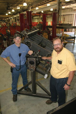

Tip #11: Optimize Fixturing / Use Fixturing Whenever Possible
A simple gearbox, like the one shown here, rotates a 2,200-lb. component. It increases safety by eliminating the use of a chain and hoist to flip the component, which in turns eliminates the source of potential hazards.
vermeerfixturejpg
By using poka-yoke (“mistake proofing” the fixture design), the fixture reduced welding time from two-and-a-half days to less than one day. Shown (L-R) are Vermeer’s Scott Beary, welding production manager and David Landon, manager, weld engineering.
