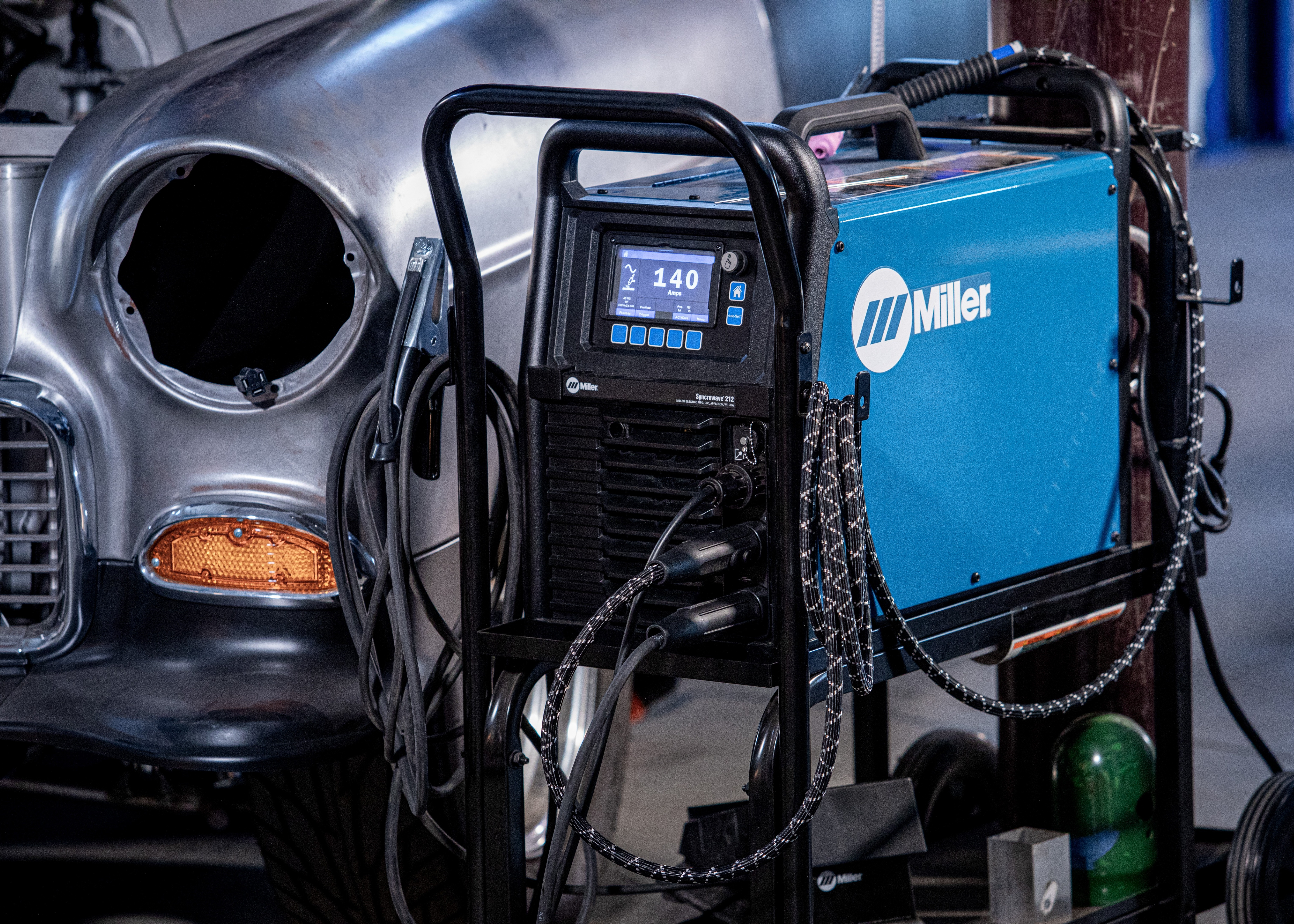

Syncrowave212_Application
As that confidence builds, TIG skills develop over time, and the right equipment should support that progression without getting in the way early on. A light‑industrial TIG machine like the Syncrowave® 212 is designed to meet welders where they are, supporting fundamental TIG learning while still allowing room to grow as experience builds.
As welders take on longer runs, more demanding materials or tighter cosmetic requirements, the ability to adapt becomes more important. Options such as water‑cooled torch capability and controls that go beyond baseline settings help support developing skills while maintaining arc stability and avoiding unnecessary complexity.
Features like Pro‑Set™ reinforce that learning‑first approach by making it easy to return to known, reliable settings. Being able to reset to a trusted baseline keeps the focus on technique rather than troubleshooting, allowing the machine to support the learning process as skills progress.
