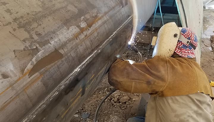

The gas or liquid inside in-service pipe cools the weld puddle very quickly. Whether it’s an oil or gas line, the material inside is much colder than the weld metal so it pulls heat away, resulting in a smaller heat-affected zone. This requires some adjustments on the part of the welder to compensate for the fast puddle cooling.
Preston Ri’chard, president of Pipeliners Union 798, has more than 40 years of experience as a pipeliner welder. His most recent work involved fabricating pumping stations for Line 3 and the Keystone XL pipeline in Minnesota on a project with TC Energy and Enbridge. Ri’chard, who often trains welders on in-service pipeline jobs, offers three tips for optimizing results with this type of welding.
Tip #1: Make adjustments during testing. For in-service pipeline work, the union tests welders with water running through the pipe to mimic welding on a pipe filled with oil or gas. Don’t put a sleeve on the pipe during testing. This helps operators see how quickly the puddle cools — so they understand which amperage levels are necessary for these welds. It often takes 40% to 50% higher amperage for in-service welds. This means operators must understand how to adjust amperage so they can fuse the metal but not burn through it.
Tip #2: Understand the parameters for the wall thickness. The ultrasound testing (UT) of a pipe’s wall thickness is critical for in-service repairs. If the wall thickness in the weld area is too thin, the operator must extend the sleeve area on the pipe. The ability to safely weld the pipe also depends on the pressure the line is running; pressure is often lowered for repair work. Pipeline owners have different protocols for different wall thicknesses. They have predetermined the interpass temperatures and pipeline pressure measurements and what wall thicknesses can be safely welded.
Tip #3: Focus on butter passes. For in-service pipe welding, a butter pass is used in place of a root pass. Buttering is a term that refers to adding weld material to build a part up. A butter pass adds a layer to an in-service pipe to help prevent burn-through. This builds up the pipe wall, making it thicker so the operator can add more weld metal to it. It’s best to carry a light puddle for the butter pass. Running two butter passes should allow the welder to tie-in to the sleeve under the long seam. Operators may prefer different angles for this pass. A butter pass is required as part of the in-service weld test, which helps operators hone technique.
