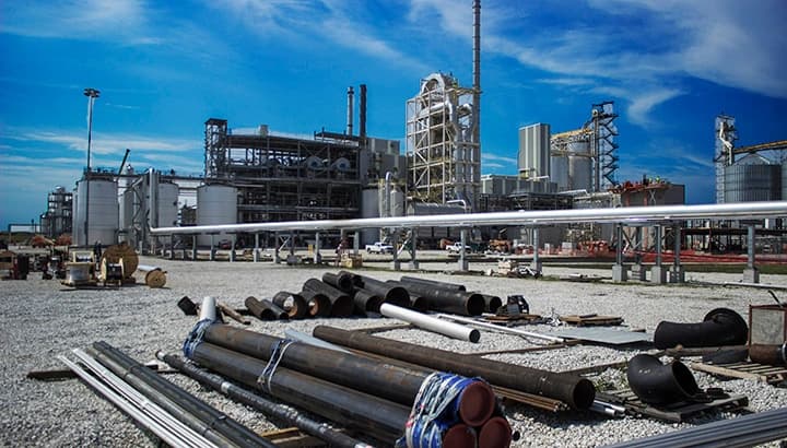

For transmission and process pipe fabrication, some applications require elevated strength and toughness levels. In these cases, high-strength steel may be the right option.
High-strength steels are being used more frequently across many industries and welding applications, including pipe fabrication and construction, that require higher strength properties without added weight. While high-strength steels deliver numerous benefits, welding these materials requires more attention to certain details, including heat input and filler metal selection.
