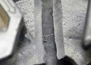

2. Bevel the joint to prepare the repair
When repairing a crack, bevel the joint down to a “V” halfway through the damaged part (see close-up below). Then tack weld it together and flip the part over to bevel and tack the opposite side. Welding on both sides adds strength and helps reduce the chance of breaking.
If both sides aren’t accessible, bevel deeper so that 70% to 80% of the part’s thickness can be filled with weld metal. Use a hand grinder with a 4 1/2-inch diameter wheel (36–80 grit) to prepare the joint. Avoid finer grits, as they can clog the wheel and embed impurities into the aluminum.
