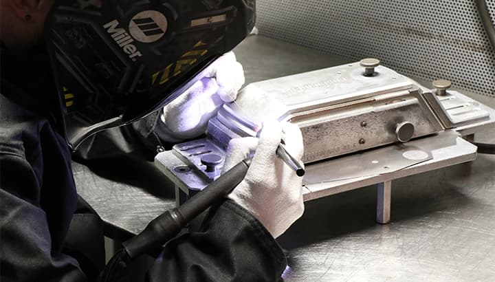

The titanium parts welded at the facility range from 0.4 millimeter to 1.6 millimeter in thickness. With material that thin, there is potential for weld distortion when heat input isn’t properly controlled.
The Burnley facility experienced issues with distortion on a specific component for one customer — resulting in added time for rework and higher costs for scrapped parts. They were able to solve the problem with a switch to the Miller® Dynasty 400 TIG welder, a continuation of their long-standing relationship with Miller welding power sources and the Dynasty family of machines.
One specific component for a customer was causing issues due to the very tight geometric tolerance, the amount of welding required on the part and the area on the part where the welding was needed. There were problems with weld distortion, causing a lot of rework and parts being scrapped.
In an effort to fix the problems, the Burnley welding operation tested the Dynasty 400 TIG welder with that specific part. The Dynasty 400 provides a higher pulse rate for pulsed TIG welding — allowing operators to eliminate the weld distortion they were seeing with that part.
“The Dynasty 400 has a maximum of 5,000 pulses per second, compared to the other machine that has 500 pulses per second,” Durkin says. “The higher pulses allowed us to lower the heat and the distortion.”
Before switching to the Dynasty 400 for that part, the rework in the sheet metal operation was taking 45 minutes to an hour to remove the distortion on each part.
“We saw a massive time savings,” Durkin says.
It wasn’t only the time savings. Passing quality testing on the first try for each part helped them hit quality goals and reduce scrap waste and costs.
“We could hit first-time yield on every part rather than scrapping some off due to weld deformation,” Hill says. “That’s really key. If we have any scrap fallout due to a geometric issue, we’ve then got to replace that part through our production plan, so the Dynasty helped alleviate that problem.”

Because the facility welds on a range of material thicknesses for some components, it’s important to have welding power sources that allow operators to easily change parameters or save welding programs for different components.
“We use complex jigs here at Safran,” says TIG welder Michael Whittaker. “With Dynasty welders, you can change the parameters very easily and very precisely, which is what you need in aerospace.”
