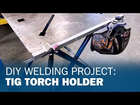

Learn how to declutter your welding table by creating a holder for your TIG filler metal, TIG torch and welding helmet.
TIG Torch Holder Project Plans
Tools and Materials
  • Miller® Multimatic® 220 AC/DC multiprocess welder
  • Flat stock (1-1/2" × 1/8"), cut to 6" long
  • Flat stock (1-1/2" × 1/8"), cut to 4" long
  • Flat stock (1-1/2" × 1/4"), cut to 1" long (Qty. 2)
  • Bolts (5/16" × 18 × 1") (Qty. 2)
  • Belt sander or grinder
  • Hammer
  • 3/4" hole saw or Rotabroach drill
  • Band saw, reciprocating saw or jigsaw
  • Letter F (.257) or Letter G (.260) drill bit
  • Aluminum square tubing (1" × 1" × 1/8")
