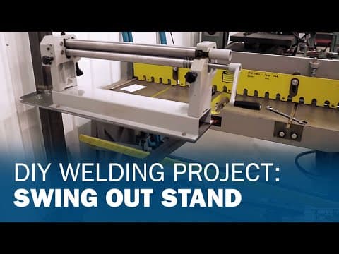

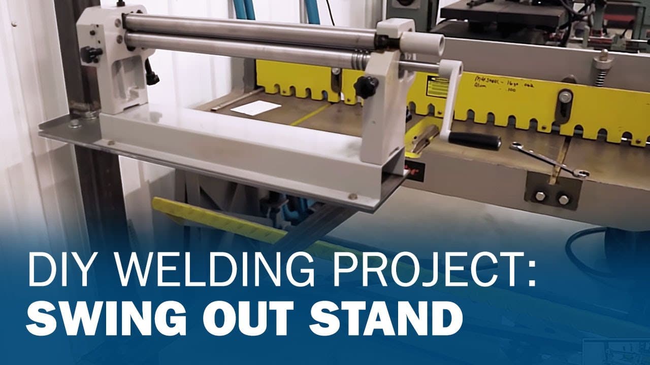

Learn how to create a heavy-duty, swing-out equipment stand to save space and heavy lifting in your garage.
Swing Out Equipment Stand Project Plans
Tools and Materials
  • Miller® Millermatic® 255
  • Miller Spectrum® 625 X-TREME™ plasma cutter
  • 3/8"-thick plate steel
    • Top base plate: 8" × 36"
    • Top swivel plate: 6" × 8"
    • Bottom swivel plates: 5" × 5" (Qty. 2)
  • 2" × 3" .120 wall tubing
  • Measuring tools
  • Assortment of wrenches
  • Drills and taps
  • Plumb bob
  • 5/16" bolts (to mount the slip roll to the stand)
  • 5/8" bolts
  • 1/2" bolts
