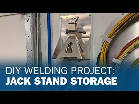

Do you have jack stands cluttering up your garage? Then check out this DIY jack stand storage rack that will help keep them all in one place.
