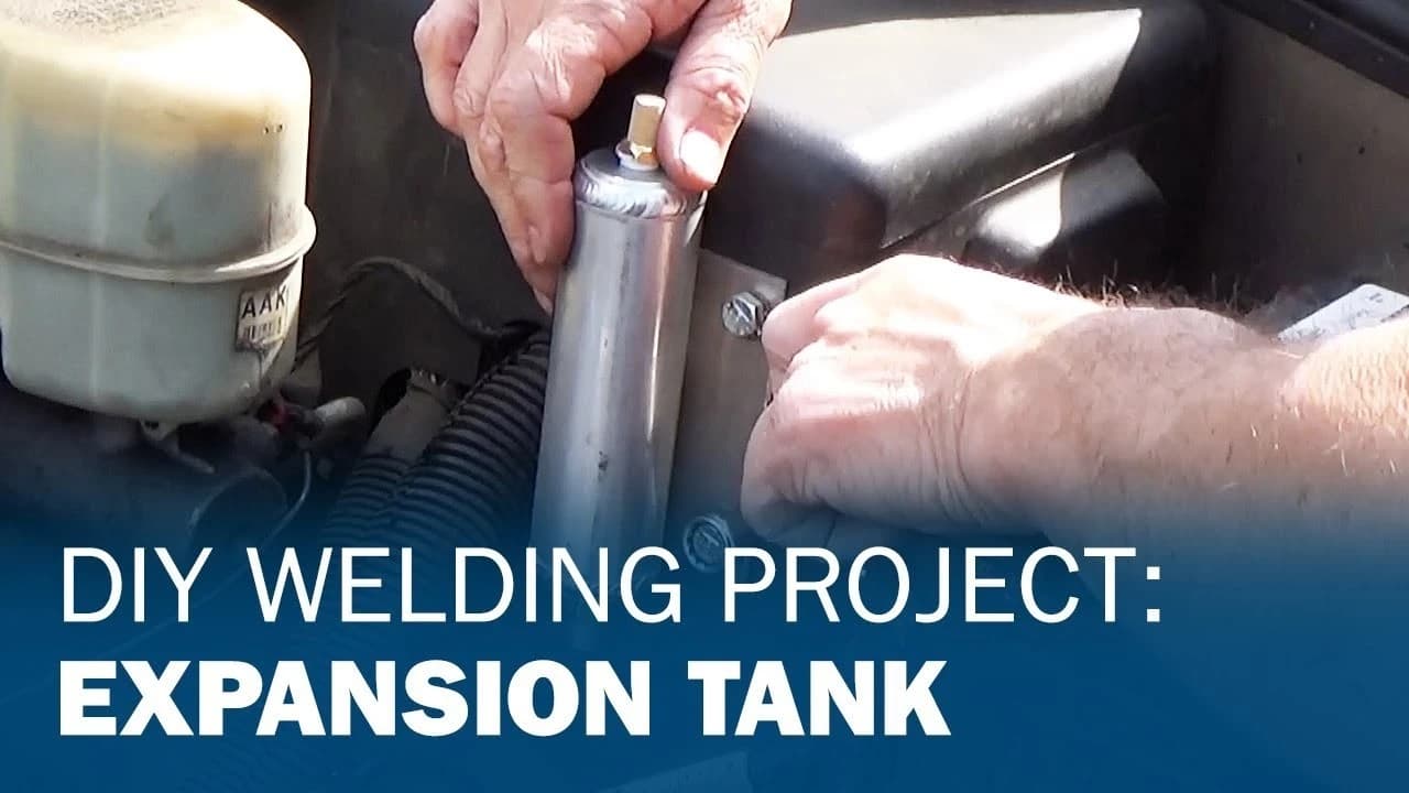

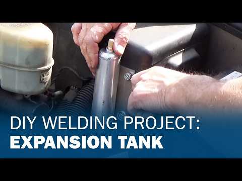

Leaking axle vent hose? Fix those worn seals or small seeps with this expansion recovery tank project.
Expansion Tank Project Plans
Tools and Materials:
  • Miller® Multimatic® 220 AC/DC multiprocess welder
  • 6063 or 6061 alloy aluminum round tubing (1-5/8" x 1/8") (5" long)
  • 1/4" aluminum plate or flat stock for the end caps
  • Sander/grinder
  • Drill bits (5/16", 7/16", 33/64", 9/16" x 18" fine tap and 1/4" pipe tap)
  • 3/32" 4043 or 4943 filler metal
  • Rivet nut setter
  • Brass filter
  • 1-1/2" x 4" x 1/8" aluminum plate or flat stock for the mounting bracket
  • Hole saw
  • Hand drill
  • Vise
  • 5/16" rivet nuts (2)
  • 1/2" wrench
