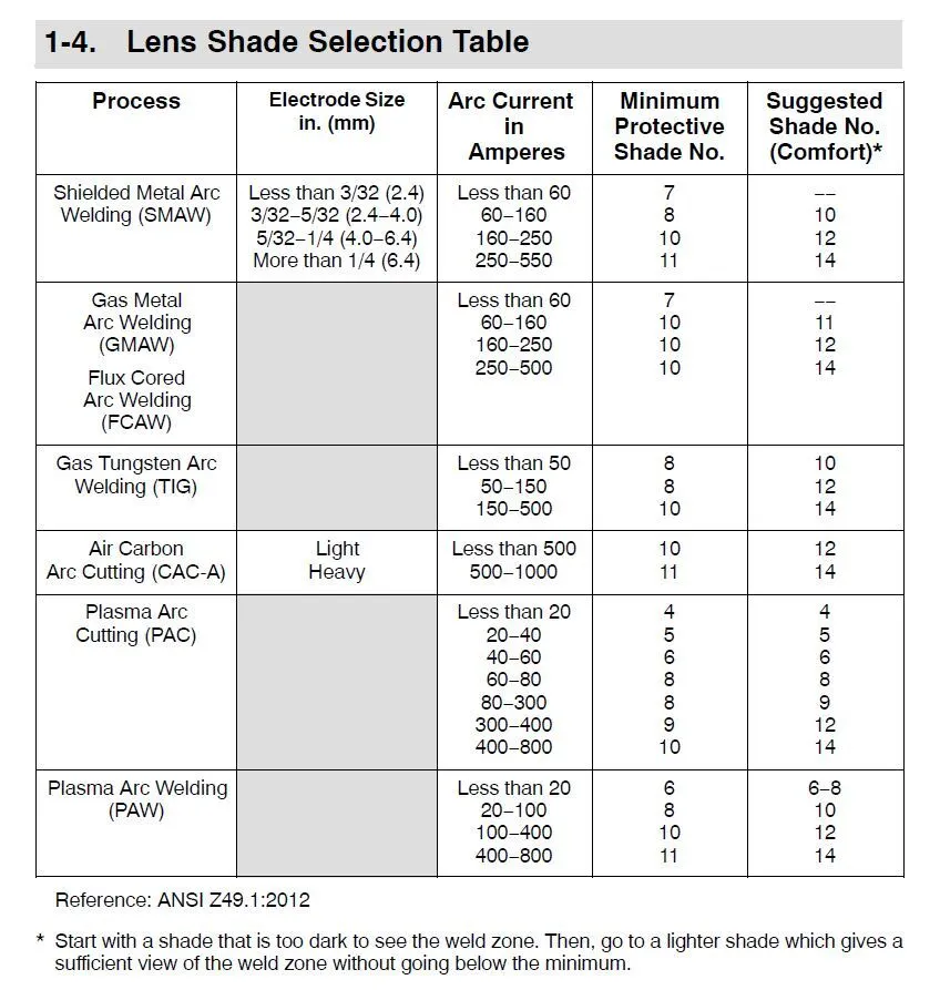

Determine how dark the welding filter gets when the welding arc is struck. Market standard shades are 8-13 with 13 being the darkest. See the chart below to determine the correct shade number for your welding applications.
Use the process, electrode size and arc current to identify the minimum protective shade and suggested comfort shade. The existing detailed lens shade chart is retained below for reference.
Start with a shade that is too dark to see the weld zone. Then move to a lighter shade that provides a sufficient view without going below the minimum protective shade.

Reference: ANSI Z49.1:2021 Safety in Welding, Cutting and Allied Processes
