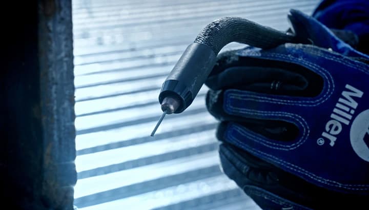

Definitions of a large-diameter wire can vary, since some applications require using larger wires all the time. Large-diameter self-shielded wires are more frequently used on outdoor jobsites. Large-diameter solid, metal-cored or gas-shielded flux-cored wires are often used in the shop.
Many people consider any wires 1/16 inch and up to be large-diameter wires. While numerous structural fabrication applications use 5/64-inch gas-shielded flux-cored wire (FCAW-G), be aware that a wire size larger than 1/16 inch often limits out-of-position welding capabilities.
For large, thick, flat-positioned groove welds on outdoor jobsites, operators may run a 3/32-inch FCAW-S (self-shielded) flux-cored wire. You could also run a 5/64-inch FCAW-S wire for the same job and use it in vertical applications.
Large-diameter wires allow operators to put down a lot of weld metal fast. This is helpful when a high deposition rate is needed to fill deep groove welds or large fillet welds.
There are several factors that determine whether a large-diameter wire is needed. These include material thickness, weld position and joint design. For example, if you’re welding something very thick — such as a large flange-to-column connection, which may require a considerable amount of heat to penetrate it — a larger-diameter wire can take that heat without the arc breaking down.
The wire diameter that is necessary for the application typically depends on the amperage needed to weld, and the amperage needed to weld relies on the base material thickness. Put simply: the thicker the material, the bigger the wire you will need.
There are no absolutes when it comes to choosing a wire diameter, however. You may be able to make the same weld size with a 5/64-inch wire or a 1/16-inch wire if you run them at different wire and travel speeds.
Your choice also depends on the wire classification. For example, one classification of 5/64-inch wire may be used to weld out of position, while another classification of 5/64-inch wire cannot be used out of position. Part of choosing the right wire classification is knowing what positions you will be welding in. Often, the larger the wire, the fewer options it provides for running it out of position.
