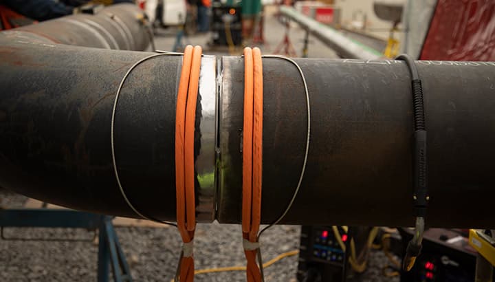

Induction: This process uses electro-magnetic fields that generate eddy currents within the base metal, heating it internally from within. Induction accessories, such as cables or blankets, placed on or near the part generate the magnetic fields. They provide continuous controlled and even heat wherever they are placed.

With ArcReach Heating Systems, operators simply attach the heating tool to the part and connect the system and thermocouples; then they are ready to preheat. Setup is typically 20 minutes or less per joint. And because induction tools don’t get hot, operators can move them immediately to the next joint without cool-down time. This delivers much faster teardown.
