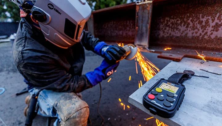

Remote solutions: New Wireless Interface Control is an option on Trailblazer® and Big Blue® engine-driven welders from Miller. Operators can remotely adjust amperage and voltage and customize welding programs. They can also turn the engine-driven welder on and off, select processes, and fine-tune the welding arc to tailor arc responsiveness to better handle changing joint conditions — all from where they’re working. ArcReach® technology is another remote solution that lets operators make parameter adjustments at the joint using a wire feeder or remote.
Modified truck mount design: A lowered ignition switch and engine display make it easier for operators to reach all of the essential controls for the engine-driven welder while standing on the ground outside of the truck.
Remote panels: The Remote Panel Kit for Miller engine drives allows operations to mount the weld terminals and power receptacles wherever is most convenient for the operator. This provides an added layer of convenience and safety. Operators can access controls and plug in tools and lights from the ground, without having to climb into the truck.
