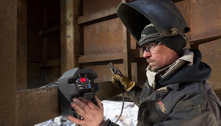

A Miller® ArcReach® stick/TIG remote binds quickly and consistently to Miller engine drives with ArcReach technology, so you start work immediately.

Arc control through an ArcReach accessory — available on all ArcReach Trailblazer® and Big Blue® welder/generators — provides precise arc control (also known as dig), allowing you to fine-tune the arc. If you encounter a tight root fit-up or need to weld out of position, turning up the arc control on the stick/TIG remote will match the application by providing a stiff arc. Then during fill and cap passes or when welding in the flat position, the arc control can be lowered — without making the trip back to the power source — for minimal spatter and desirable wetting at the toes to create an excellent-quality finished weld.
Having arc control allows you to match your welding preferences and quickly dial in the proper parameters using the remote — to optimize weld quality and maximize productivity. This delivers more flexibility and greater control.
