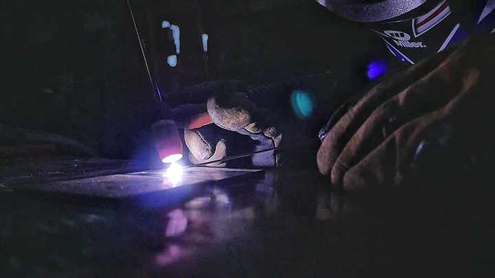

TIG welding sheet metal

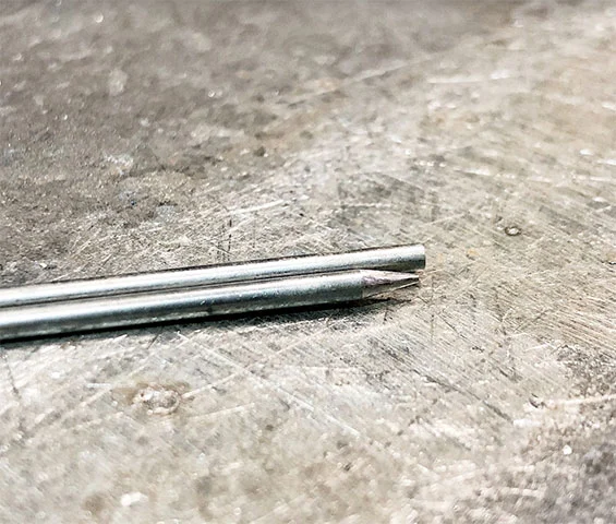

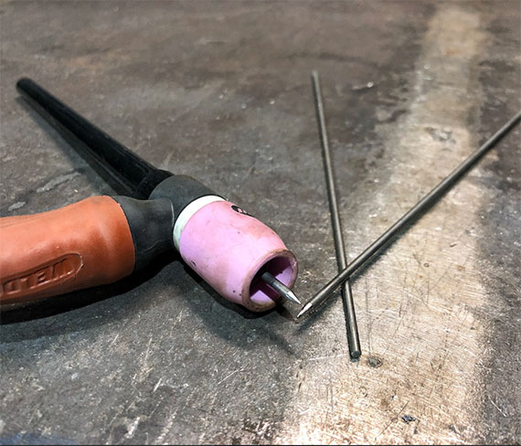

Forget the larger 1/8-inch tungsten electrode and use a smaller one. Ceriated tungsten are preferred, with thoriated tungsten as a second option. The diameters down to .020, .040 and 1/16-inch tungsten are popular. Smaller electrodes start easier and perform better at lower heat settings, which helps prevent burn-through and allows you to better focus the arc in a smaller area. For steels, keep the tungsten pointed, and grind it parallel with the length.
While ER70S-2 filler metal is a common choice for steel, another popular option for welding sheet metal is silicon bronze. It is softer and finishes well, while reducing the heat required to weld it. It’s also important to select a filler metal that is thinner than the base metal, or as close as possible. This ensures you won’t overheat the base metal before the filler metal gets a chance to join with it.
For optimal results on thin aluminum, use an inverter-based power source. While it’s common to weld with a pure tungsten that is balled at the end, with an inverter-based welder, you can use the same ceriated tungsten and prepare it the way you would for steel applications. Compared to the balled pure tungsten used with conventional TIG welders, a pointed electrode provides greater arc control and enables you to direct the arc precisely at the joint to minimize distortion. Typical aluminum alloys for sheet fabrication are 3003 and 5052.
Filler metals for either of these would be 4043 or 4943. A 5356 filler metal also works for 5052 materials specifically.
TIG Techniques
To prevent burn-through and warping, don’t whip or weave the torch; the more time the arc is in an area, the hotter it becomes. Always travel in a straight line and use the fastest travel speed possible that maintains a good bead profile. Another way to prevent burn-through is to use a push technique of the MIG gun. This points the wire at the cooler edge of the base metal and puddle compared to pulling the gun, which directs the wire toward the hotter portion of the puddle — increasing chances of a blowout.

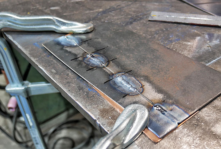

Skip welding:
Unevenly distributed heat causes distortion and warping, which wreaks havoc on parts that should fit together. To minimize warping, distribute heat as evenly as possible. You can accomplish this by using a skip welding technique, which involves making a series of intermittent or stitch welds.

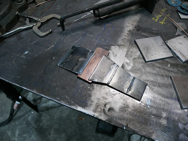

Backing bars:
To dissipate heat faster than atmospheric cooling alone, place the heat-affected zone in contact with a backing or chill bar. This can be as simple as a metal bar (usually copper or aluminum because they dissipate heat best) clamped to the back of the weldment.
