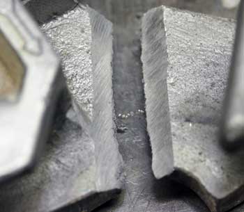

When repairing a crack, bevel the joint down to a "V" halfway through the damaged part (see close-up below). Then tack weld it together and flip the part over. Bevel out an identical "V" groove on the opposite side and tack that together. Welding on both sides adds strength and reduces any chance of breaking. If you cannot access both sides of a damaged piece, simply bevel deeper so that 70% to 80% of the damaged part's thickness can be filled with weld metal. Use a hand grinder with a 4 1/2-inch diameter wheel (36-80 grit) and bevel the damaged crack/joint. Too fine of a grit can clog the grinding wheel and won't effectively grind the joint. It may even embed impurities deeper into the aluminum.
