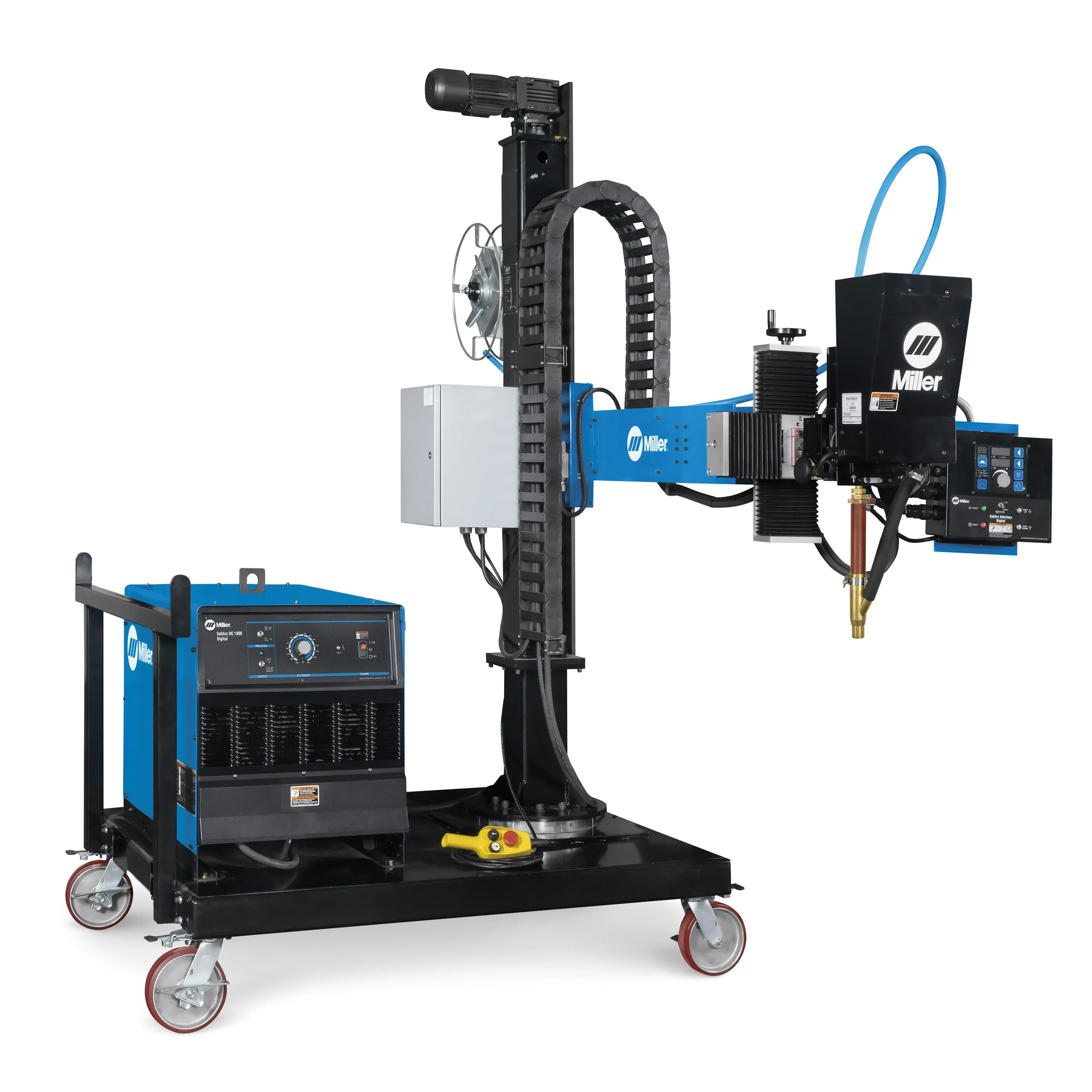

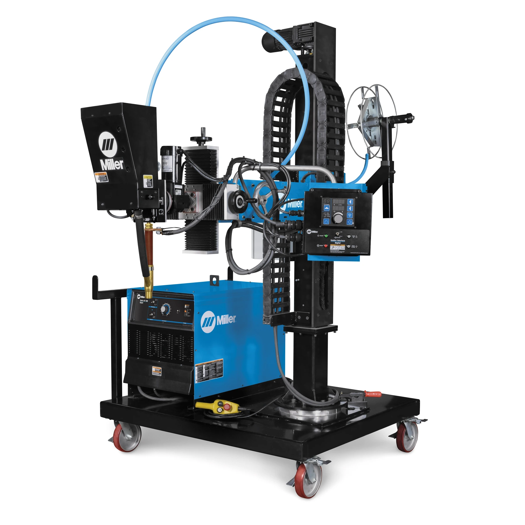

  • Self-contained system
    houses power source, column and boom on a mobile platform, providing a compact, turnkey submerged arc welding solution.
  • Built-in fork pockets and caster wheels
    provide mobility options to move the welding system to your workpiece
  • Ease of positioning the weld head
    through use of integrated motorized column, manual telescoping boom, cross slides and 360-degree column rotation.

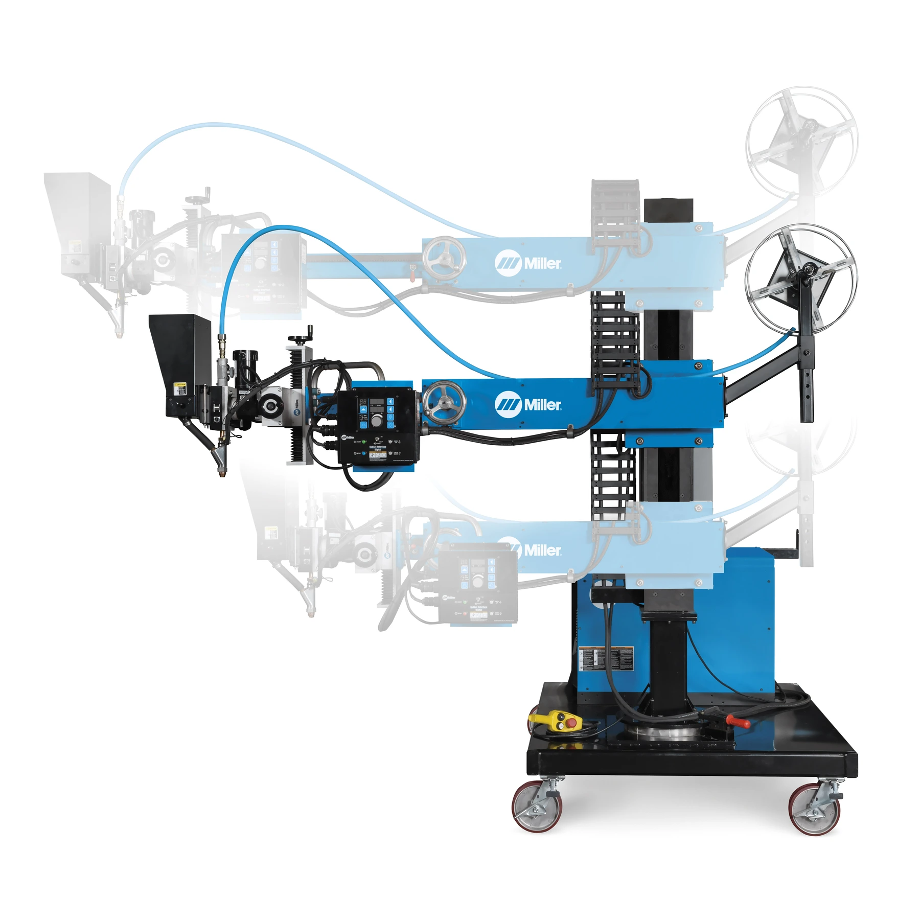

  • Motorized column with pendant control
    provides 44 inches (1,117 mm) of vertical travel to accommodate workpieces of various heights.
  • Manual telescoping boom
    provides 31 inches (787 mm) of horizontal travel.
  • Manual cross slides
    Manual cross slides provide 7.87 inches (200 mm) of fine vertical and horizontal torch adjustment.
