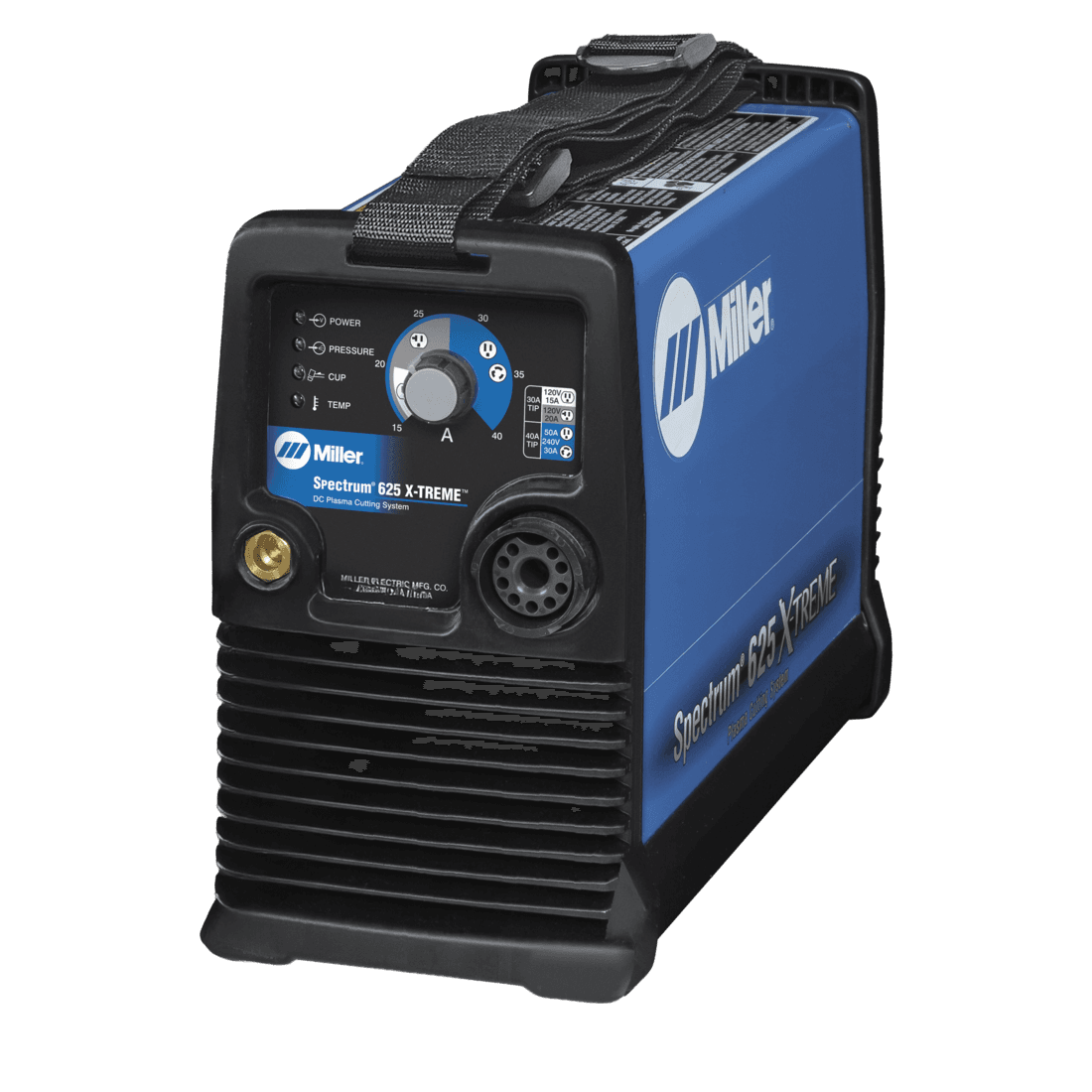

Spectrum® 375 X-TREME™
Cuts up to 3/8 in. mild steel. The unit offers easy connection to 120V or 240V input with Auto-Line technology and MVP Adapters.
Plasma cutting is used in cutting and gouging applications, and requires compressed air and electricity to create plasma gas. Miller plasma cutters can cut up to 7/8-inch steel and stainless steel material, and up to 5/8-inch aluminum material. Explore our full line of plasma cutters with features like flexible cables, Ultra-Quick connect plasma torches and machine torch capable models.
| Cutting Capability | Spectrum® 375 X-TREME™ | Spectrum® 625 X-TREME™ | Spectrum® 875 | Spectrum® 875 Auto-Line™ |
| Rated | 3/8 in. | 5/8 in. | 7/8 in. | 7/8 in. |
| Sever | 5/8 in. | 7/8 in. | 1-1/4 in. | 1-1/4 in. |
| Power | ||||
| Rated output (amps/duty cycle) | 30A at 40% | 40A at 60% | 60A at 40% 1-phase (230V) | 60A at 50% 1-phase (230V) 60A at 60% 3-ph. (380–575V) |
| Input power (V) | 120/240 1-phase | 120/240 1-phase | 208/230 1-phase | 208-575 1- or 3-phase |
| Max amperage (A) | 30 | 40 | 60 | 60 |
| Weight with torch | 19 lb. | 21 lb. | 49 lb. | 54 lb. |
| Features | ||||
| MVP™ | X | X | ||
| X-CASE™ | X | X | ||
| Fan-On-Demand™ | X | X | X | X |
| Auto-Refire™ | X | X | X | X |
| Wind Tunnel Technology™ | X | X | X | X |
| Automatic air regulation | X | X | X | X |
| Ultra-Quick Connect™ torch | X | X | X | |
| Automation options | X | X | ||
| Auto-Line™ | X | |||
| Pricing | $ | $$ | $$$ | $$$$ |
