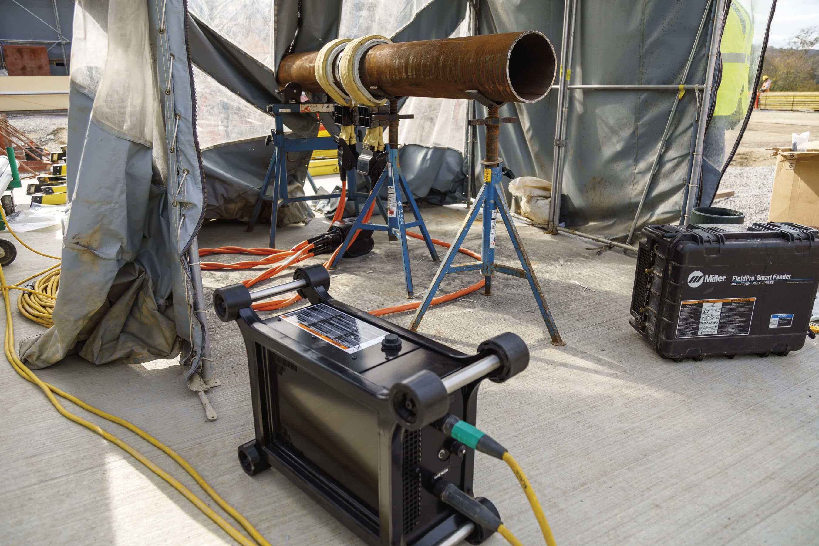

Meet deadlines and protect your budget with ProHeat™ and ArcReach® induction heating. Unlike flame or resistance, induction turns the metal into its own heat source for fast setup, precise control, uniform temperatures and efficient heating that keeps jobs moving.

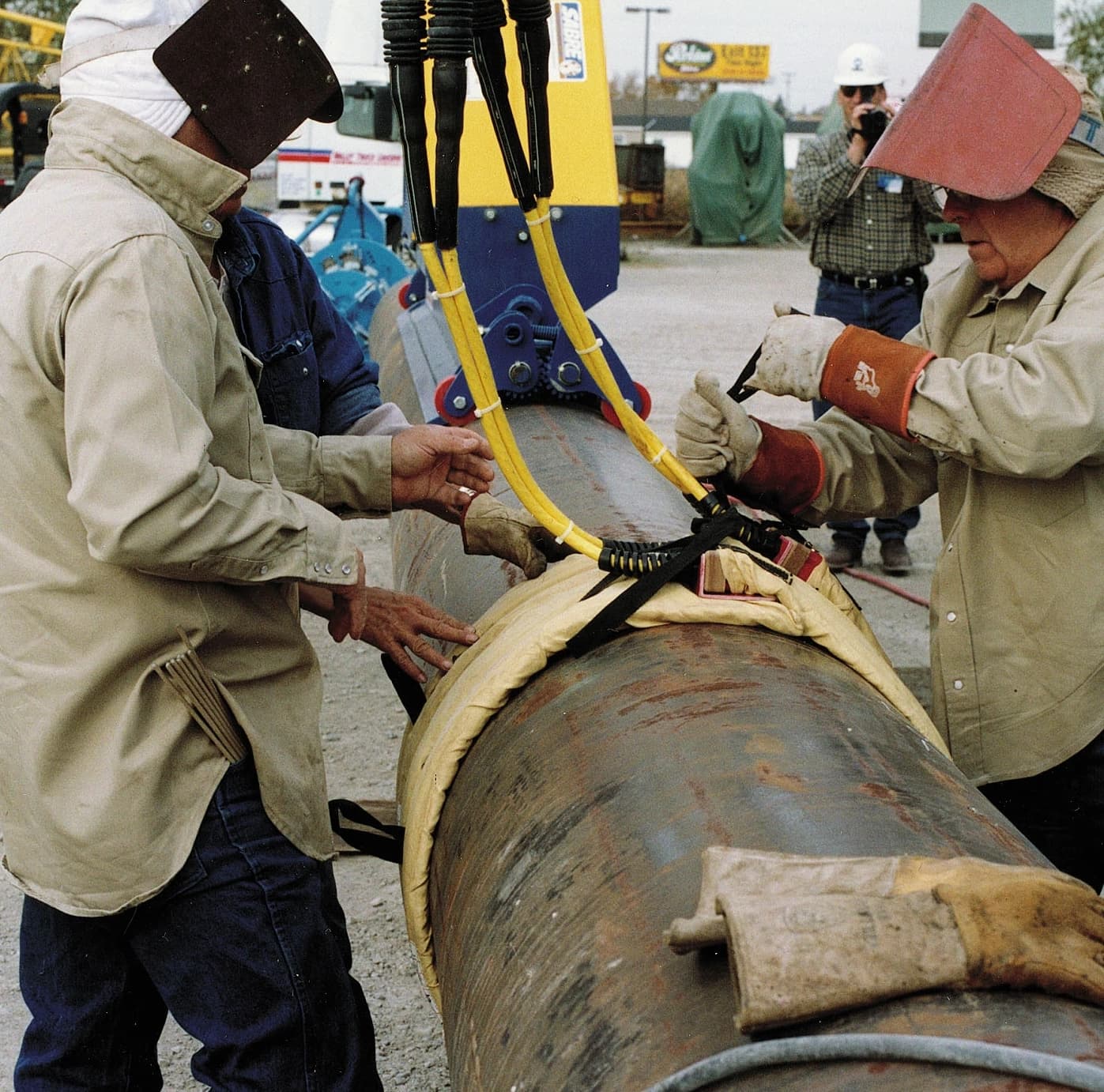

| Induction Heating | Flame | Resistance | |
| Reduce Injury | Exceptional Only the part gets hot | Poor Open flame causes burns and exposure to toxic fumes | Poor Accidental touching can cause burns, broken pads can cause shocks |
| Reduce Labor | Good Fast setup/teardown No operator required during heating process | Poor Operator required to handle torch Often requires fire watch | Poor Slow and complex setup and teardown in many cases |
| Reduce Inefficiencies | Good Easy to self-perform Heating efficient with utility use | Poor Most heat is wasted into the air Inefficient with utility use | Poor Bad electrical power factor causes inefficient use of utility A lot of heat wasted in the process |
| Reduce Time to Heat | Good Heat is generated within base material Focused heat over the entire part speeds heating process | Poor Torch needs to be continually moved to heat entire part, resulting in slower heating speeds | Poor Heat is generated in the element instead of the part Unfocused heat results in slower heating speeds |

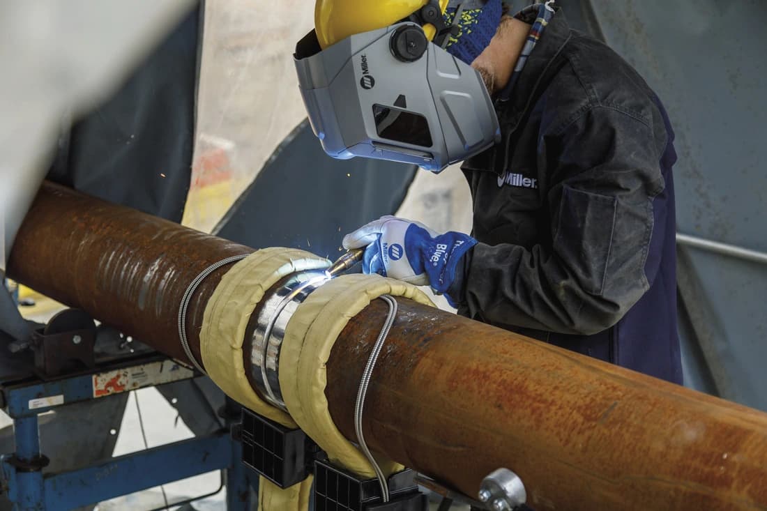

“With the change to wire processes and induction heating rather than open flame, that same weld takes five and a half hours to complete — a 52% increase in productivity.”
Senior Welding Engineer With TC Energy
