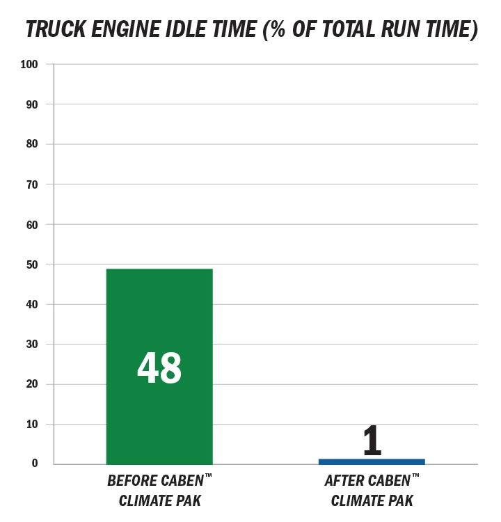

Wheeler first tested the system on one truck in its fleet. From January to the middle of June — before the new system was installed — idle time on that truck averaged 48%, with fuel costs due to idling totaling $700. Data from the truck showed idling spikes on very hot days, so the team knew it was linked to temperatures. Cline set a goal of reducing idle time to 10% on that truck.
“I told the tech if we hit 10% I would be elated,” Cline says. “The results we’re seeing are dramatically better than we expected.”
The system was installed in mid-June during the heat of a Utah summer — a perfect time to test the capabilities.
“I asked the tech if it hindered anything he would normally do. If it’s 98 degrees outside, is it getting cool enough in the cab? Is it making his life uncomfortable?” Cline says. “He told me 'No, it’s working great.'”
Engine idle reduction
On top of the cooling performance, the system quickly proved to be a great idle-reduction solution. Within a few weeks, that technician had his truck down to 1% average idle time.
“Looking at the data, you can see on this day his engine fan was on for 73 minutes the entire day,” Cline says. “That means he drove to his work location and turned it off. He’s just not running his engine. One day it was 110 degrees, and he still didn’t have to idle. That tells me this is a huge benefit and he’s not having to worry about it.”

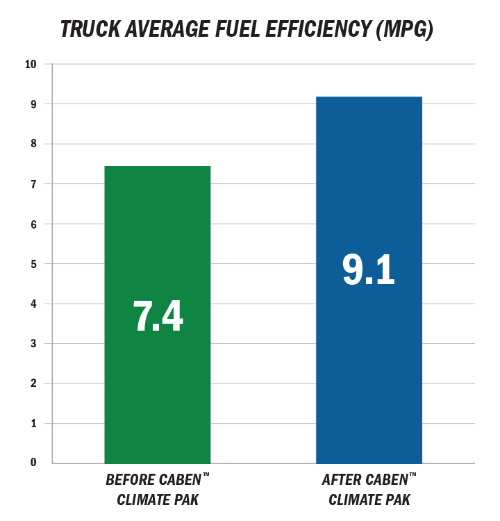

The truck’s fuel efficiency also increased significantly — almost 2 miles per gallon — with the EnPak A60 and the CabEn Climate Pak solution.
From April 28 to June 25, the truck averaged 7.4 mpg and 48 hours of idle time. In the six weeks following system installation, the truck averaged 9.1 mpg and logged only 34 minutes of total idle time.
“That’s a huge gain,” Cline says. “For me, that’s a massive difference. Looking at fuel savings is a good picture we can look at to compare.”
