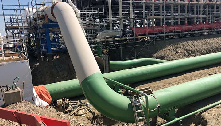

After discussion with contractor partners and appropriate vetting through laboratory testing, TC Energy recently trialed several wire welding processes on jobsites in the field. For large-bore pipes on several projects in Alberta, TC Energy switched from the SMAW/SMAW processes to waveform-controlled gas metal arc welding (GMAW-WFC) and flux-cored arc welding (FCAW) processes. The company also trialed induction heating for welding preheat on those large-bore pipes, comparing it to the traditional open flame preheating method.
Traditional processes vs. wire welding
On pipe welding projects in the field, contractors for TC Energy had previously preheated the weld with a torch and used an F3 (E6010) root pass followed by F4 (E*018) SMAW for the remaining passes on thicker P1 pipe material.
For the trial of wire welding processes on some projects, TC Energy utilized Regulated Metal Deposition (RMD®) — a type of waveform-controlled GMAW process from Miller Electric Mfg. LLC — for the root pass followed by FCAW for the fill and cap passes on any pipe greater than 16 inches in diameter. They also trialed induction heating for welding preheat in conjunction with the welding process change. For pipes less than 16 inches, contractors had the option to continue using traditional thermo heating processes.

The company saw significant gains with the switch. Previously, welding a 48-inch pipe approximately 1 inch thick with F3/F4 weld passes took about 11 and a half hours to complete (including flame preheating). With the change to wire processes and induction heating rather than open flame, that same weld takes five and a half hours to complete — a 52% increase in productivity.
