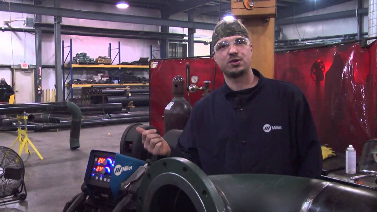

Pipefitter/Welder Brandon Saling with DE-CAL (UA Local 396) confirms that welding downhill with the RMD process and using a weld positioner is particularly effective and allows him to complete identical welds much quicker than with stick.
“When you’re putting a 6010 root in with stick, it’s dirty, you’ve got to have a wire wheel and clean it up, and it’s never quite as smooth as RMD,” he says. “RMD is much faster because you can go all the way around the pipe from tack to tack. Whereas if I’m welding 12-inch pipe with stick, every time I’m done burning a rod I’ve got to throw it to the side, grab another rod, so it takes longer. Compared to uphill in the root with 6010, it’s gotta be maybe 2-3 times faster (with RMD).”

“I like that it has a programmable memory so as I’m working with different size pipe, I can just either hit the trigger select or come up here and hit the memory and it will pretty much put the settings right where I want for each size pipe that I’m welding on,” says Saling. “I also like the trigger hold on it. If I’m welding big pipe, 24- or 30 inch pipe, all I have to do is hit the trigger one time, it starts welding and I don’t have to worry about holding it until I’m done because I can just hit it again, and that’s it.”
As DE-CAL has largely standardized on RMD and flux-cored, process changeover with the PipeWorx and its dual wire feeder (with solid wire on one spool and flux-cored wire on the other) is as simple as picking up the appropriate gun and hitting the trigger.
“It’s really convenient because, instead of having two different machines or a dual wire feeder, you just have an all-in-one unit so all you have to do is have both guns next to you, pick one up, and the machine automatically selects it as soon as you hit the trigger,” says Saling. “As soon as you’re done putting your root in with the RMD, you pick up the other gun. And as soon as you hit the trigger it automatically switches your settings to flux cored. So it’s really convenient that way.”
